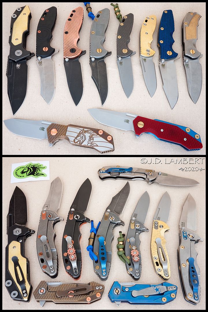

I've got Gen 1 and Gen 2 Half Tracks. The flipping action on the Gen 1s is generally not great. You have to do it just right or use a little wrist to get it fully open. However, the pivot tightness/centering issue you're describing doesn't sound normal. I'd contact Hinderer and have them look at it.
I'd highly recommend checking out a Gen 2. I like pre-Triway XMs, Eklipses, and MP-1s but I feel the Triway Half Track is much better than the Gen 1.
These are my Gen 2s.
The only Gen 1 I still have is this one with the horse head. I just keep it for display.
