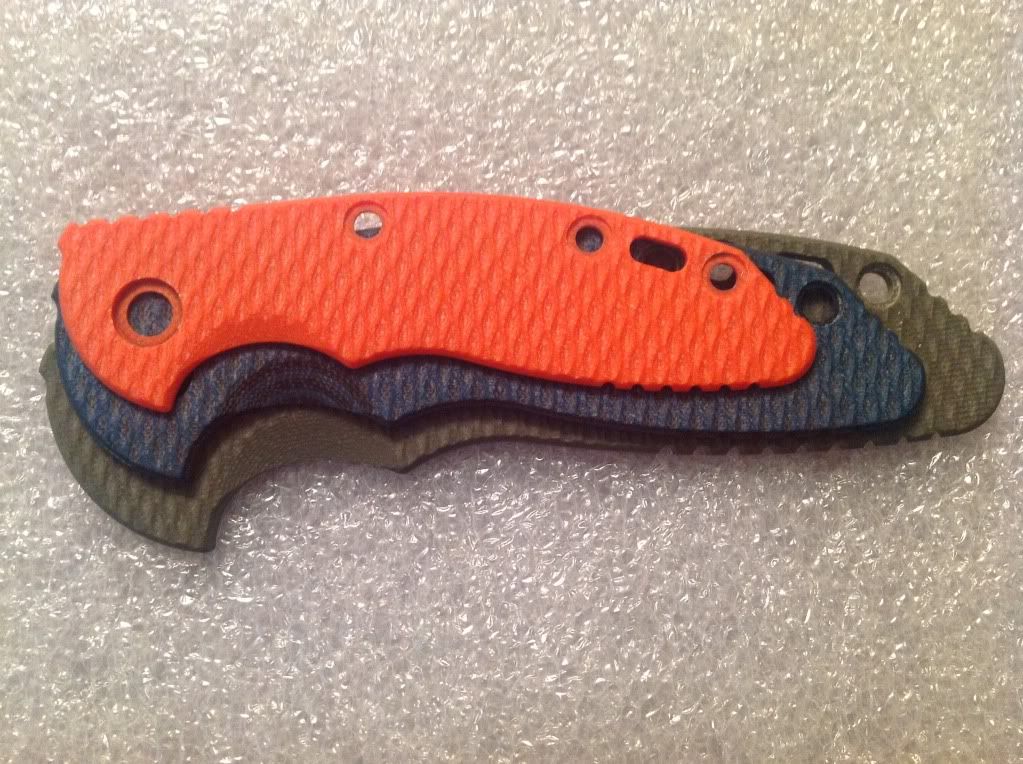

Please excuse image quality. The colors are not accurate to how these look IRL, it's simply for size comparison.
3" atop 3.5 with 24 on the bottom...
The scales are not interchangeable between models, but...
All 3" XM scales will fit all 3" XM-18s.
All 4" XM scales will fit all XM-24s.
The anomaly is 3.5" XM-18s. For the most part, most 3.5" scales will fit. But Titanium for 3.5" will not fit a Gen 4 with its relocated stop pin.
Early Generations of the 3.5's had partial Ti liners and other design differences from current models, but I think your question is about fitment of scales on newer production models. More information about scales on early Generation 3.5s has been posted on the official Hinderer site in the past.
