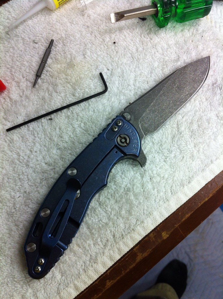

I am well aware that pimping a Hinderer voids the warranty. But this knife is a beast and I don't worry that it will ever require warranty work. This is my own personal XM. I love the working finish and the black DLC blades even more but they are rare and cost a premium. So I decided to darken the blade myself. It's 20CV. So I acid washed it in Radio shack etchant (full strength) for 10 minutes. Then stonewashed. Then I went ahead and did a dark blue Ano to the lockside.

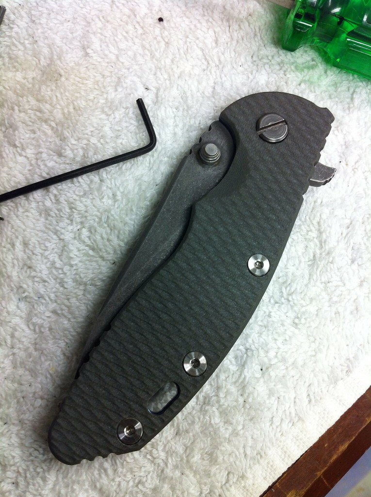

I wanted the handle to be light colored to contrast with the blade but the Battleship gray was still to dark. So I spray painted it with light gray Rustoleum. Three layers.
Before

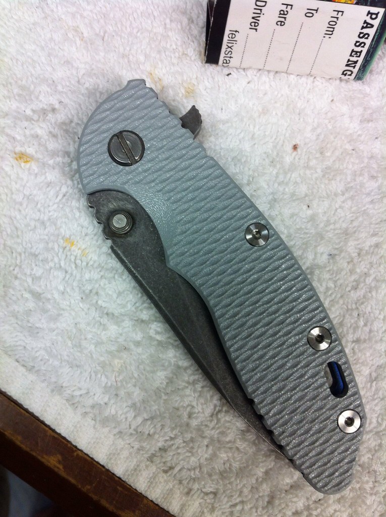

After

This looked way to "perfect" for the blade though so I decided to sand off the ridges. This took quite some effort with scotch-brite pads so the paint really took well to the G10!!!
