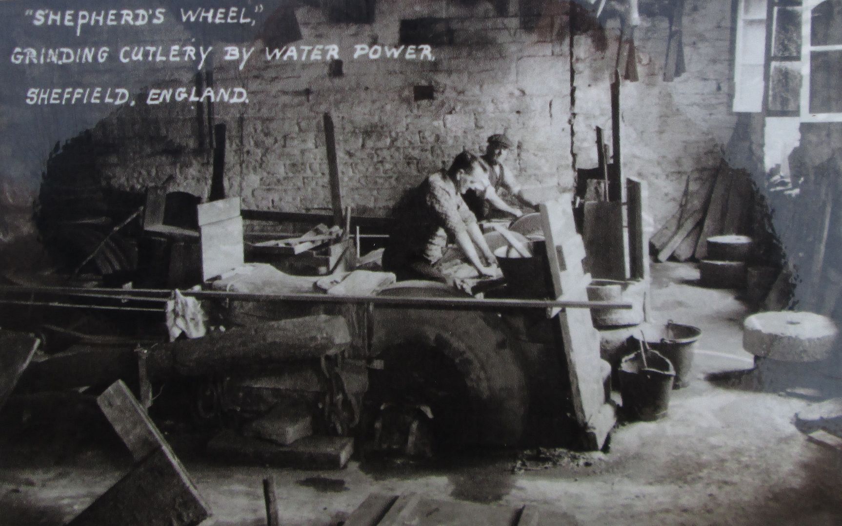

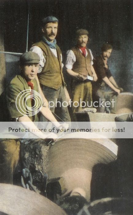

The wheel - Flat grind is done on a flat type belt.
Makers now days as in the past are using very large wheels to grind with.
And when you use a wheel 14'' or larger to grind a slip joint blade, they come very close as if you flat ground them.
I think it's a lot easier to set up a wheel type grind, than it would be a flat grind?
I'm talking more about the past - like late 1800's - early 1900's
Just my thinking.:)
Al,
Thanks so much for posting these pictures. It really helps.
Any idea what sort of grinder is used to produce the hollow grind we so commonly see today? More to the point, any idea when that sort of grinder replaced the large grinding wheels like the ones in the pictures you linked to?

Seeing all those cool old photos above I would only add that with those large grinding wheels it is also possible to create concave grind via "rocking" the blade. T ishat how the Windmuehle knives from Soligen are still being ground. I do have to add that at the video I have seen they use side of the grinding wheel.
do you mean convex? Yes flat and convex grinds could be achieved with a wheel, and just trued with stones... grinding with a wheel is not necessarily the same as impressing its shape in the steel as it were a die.
The earliest process I have read about that used hollow grinding was Japanese that used massive natural wetstones to do their grinding on. To the point where their hollow grinds appear flat.
The reasoning is quite simple and even the romans used it. Natural stones were used and it is easier to form a natural stone to a semi circle to run on a axle.

I understand that the old large grinding wheels could produce a shallow hollow (concave) grind - one that could even appear to be flat.
I'm interested in the development of the more severe and pronounced hollow grind like we see on some Case and nearly all Buck knives, among many others.
Am I correct that this sort of grind only became possible in mass production with the advent of smaller grinding wheels, which in turn became possible with the availability of high speed electric motors? This would have started during WW2 and then trickled out to knife makers during the 50s and 60s, no?
