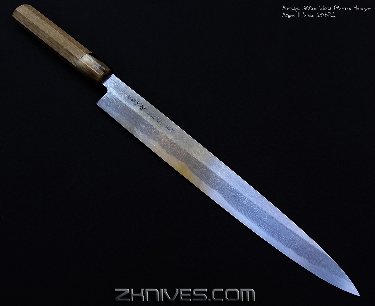

That style is called yanagi-ba. It is a sashimi knife ( not a sushi knife). Yanagi-ba is normally single bevel, but can be made in a Western double bevel grind and would be called a gyuto.
Your handle looks a bit too round and fat in the middle. The blade should have less drop from the spine and more edge rise at the tip.
Handle should be Wa- octagonal
D - oval with a ridge on the use hand side
Oval - oval around a 3:2 ratio.
Here is a classic yanagi-ba:
