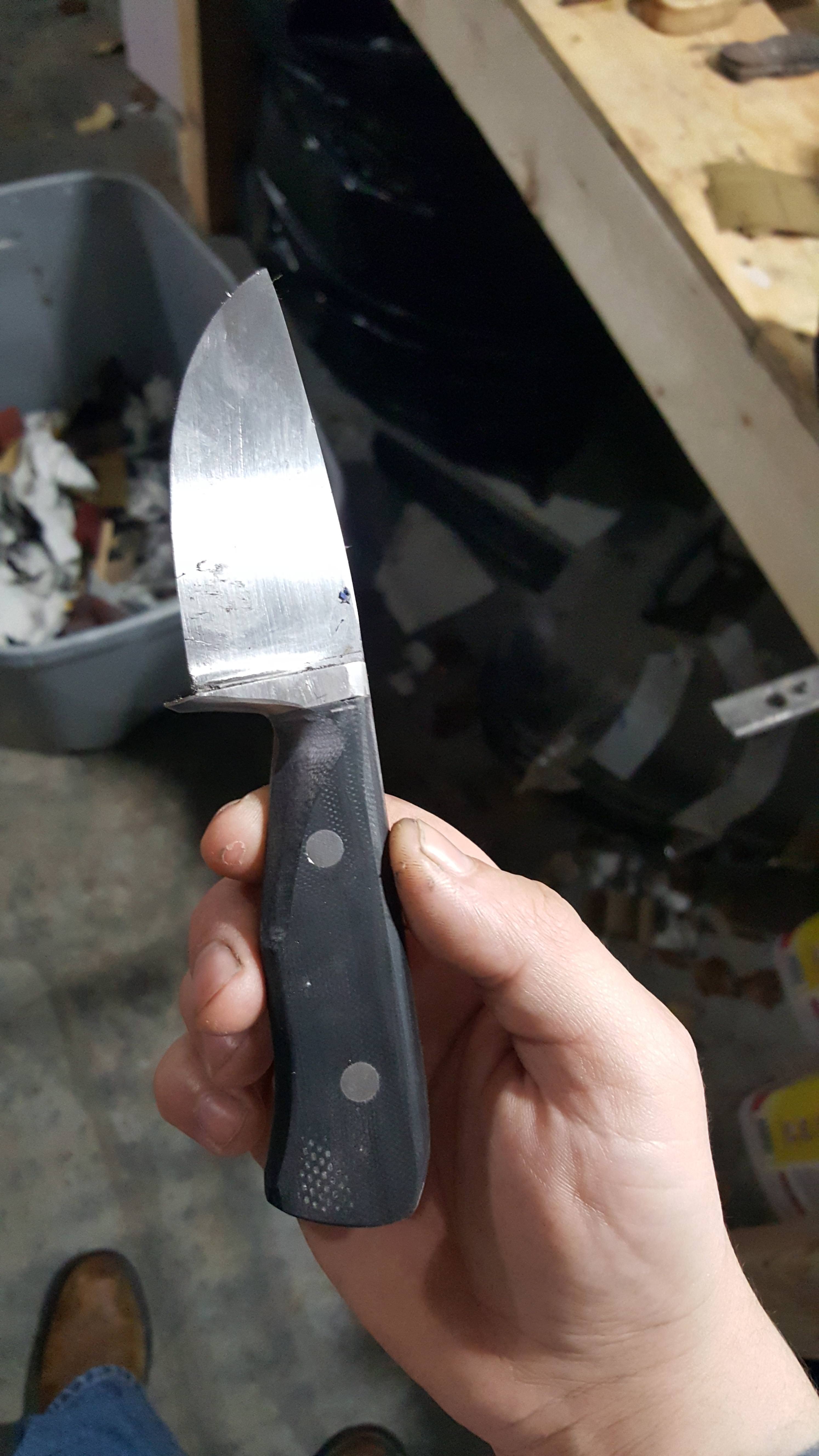

Ever happen to anyone where you mess up/ ruin blade after blade after blade? I've messed up the last 4 knives possibly 5 if this one doesn't work out. Its little things like huge divit in blade that i cant grind smooth and a tapered tang that won't get flat.
Anyways, what do yall do when you seem to hit a rut and things just dont seem to go right?

Slow down and walk up to your grinder with confidence. If you start grinding thinking that you're going to make a mistake you will.
Try to figure out why you're gouging your blades. To much pressure on the plunge, or center of the blade. Are you flat when the blade contacts the belt? Or are you contacting the belt with the tip or plunge first. Grinding for me is hard. It's an art of constant correction, not getting a perfect grind.
This is just a suggestion, but stop doing tapered tangs until you learn how to grind the bevels.
You are wanting to go faster than your skills are capable of at this stage if you are ruining blade after blade. Perfect one skill set like perfect bevels on every knife. Step away and figure what you are doing wrong and what you need to do to correct it. Get in a habit of doing things the same way don't jump from this to that or the other. My routine is enter the shop check the lights put away any tools I may have left out the day before. I clean my Benches and inspect my grinders and grease bearing if needed inspect any tooling I will be using and gather all the bits I will use for drilling....I get everything ready in close reach for all my tasks before I start. Now I'm ready everything I need is ready and I haven't ruined any steel but my mind is clear on what my plan is for the blades I will be working on.

i think you should save the tapered tangs until you have confidence and consistency in your bevel grinds. to me, a tapered tang is just like a long thin flat grind. if you cannot repeatedly do a good flat grind on a bevel, chances are the taper will not come out well. concentrate on getting the simple things to your satisfaction, then try more challenging stuff.

Nail one thing down every knife you make. While I do screw up on every knife, or feel like I do, it's rarely the same thing over and over. More often it's trying new things, or new order of operations.
I don't dick bevels up anymore, not to the point that I can't fix them. So get that nailed down. Early in tradeschool I was squaring up a block in a bridgeport and screwed it up, making a parallelogram instead of a cube. I was going to chuck it and start over, but my instructor stopped me and said "Anyone can do this from scratch. It takes more skill to fix it" and left me to figure out how to straighten it out. That's stuck with me my whole career, sometimes maybe to a detriment as there is such a thing as throwing good money after bad, but when you're learning, I think it's important to fix your mistakes rather than starting over. For two reasons, one, to learn how to fix simple mistakes or how to alter the project to eliminate the mistake, and two, as a punitive exercise in why you should slow down and do things right the first time. Especially when you're the engineer, designer, machinist, grinder and salesman all in one. The knife isn't ruined until you say it's ruined, even if it doesn't turn out as you initially planned because it's shorter, thinner, and has a different profile. So what.

Thanks for the advice gentleman. This one knife im on is the first ive ever head an issue with divits. But i think i got it down. And i think yall are right im getting too ahead of myself. I figured out the tapered tang. But now im trying slotted guard full tang. And things that are just out of my expertise. So im going to take everyones advise and slow down. And back up. Kuraki i love that advise. Makes alot of sense.

The hidden tang knife was a wash. I have a problem with trying to get things just right then next thing i know theres not alot of handle material left lol.
Ive done quite a few tapered tangs just havent quite "mastered" it switched to thicker stock and adjusted my process and bingo. Well first slotted guard i couldn't get the transition to the choil area round then next thing i know im left with half an inch of handle width.
I have yet to find a good tutorial on slotted guard for full tangs. And how to shape them and your scales
