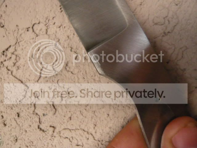

OK, so I gave it a try again and got about the same results that I have before. I held the tip in one hand, and I tried with and without a magnet for the other hand, blank parallel with platen as if tapering the tang. One particular area I've had trouble with in the past is the bottom of the ricasso, between edge and handle. You can see in this pic that I get a low spot there. Since I've seen that before, I biased my pressure towards the opposite side, but it still happened. (This photo was taken after quite a bit of hand sanding post-grinding trying to make it flat again, so it was even worse when it came off the grinder.)
Can anyone tell what I might be doing wrong here??
I'm guessing you're applying pressure to that area and it's getting more belt love than the rest of the tang. That or you're applying and removing the tang from the grinder in roughly the same spot. Remember that when you're holding the tip of the blade it's angled, so your blade is probably approaching or leaving the grinder at an angle until you get it on or off the belt.
Easiest way I tapered tangs is to hollow grind the tang, leaving very little material to be flat ground. Flat grinding, as you know, stresses the equipment and belts.
I agree with Will , it looks like your approach is off and that section is hitting the platen 1st . Start from the top of the platen and butt of tang , then slide on down keeping even contact .
That must explain it guys, because I was focusing pressure towards the other side somewhat.
Thanks for the tip of starting at the top of the platen and sliding down, Jack...sounds like that would help!
