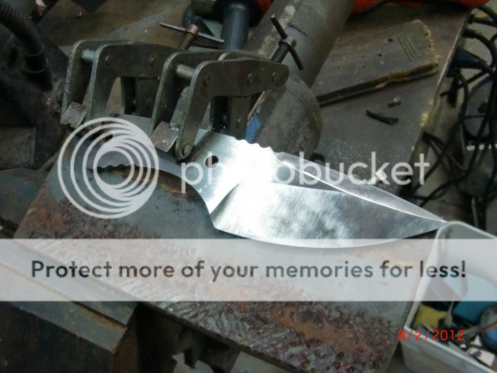

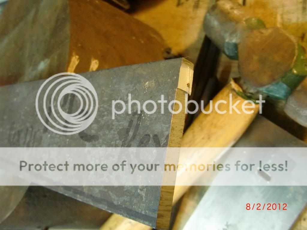

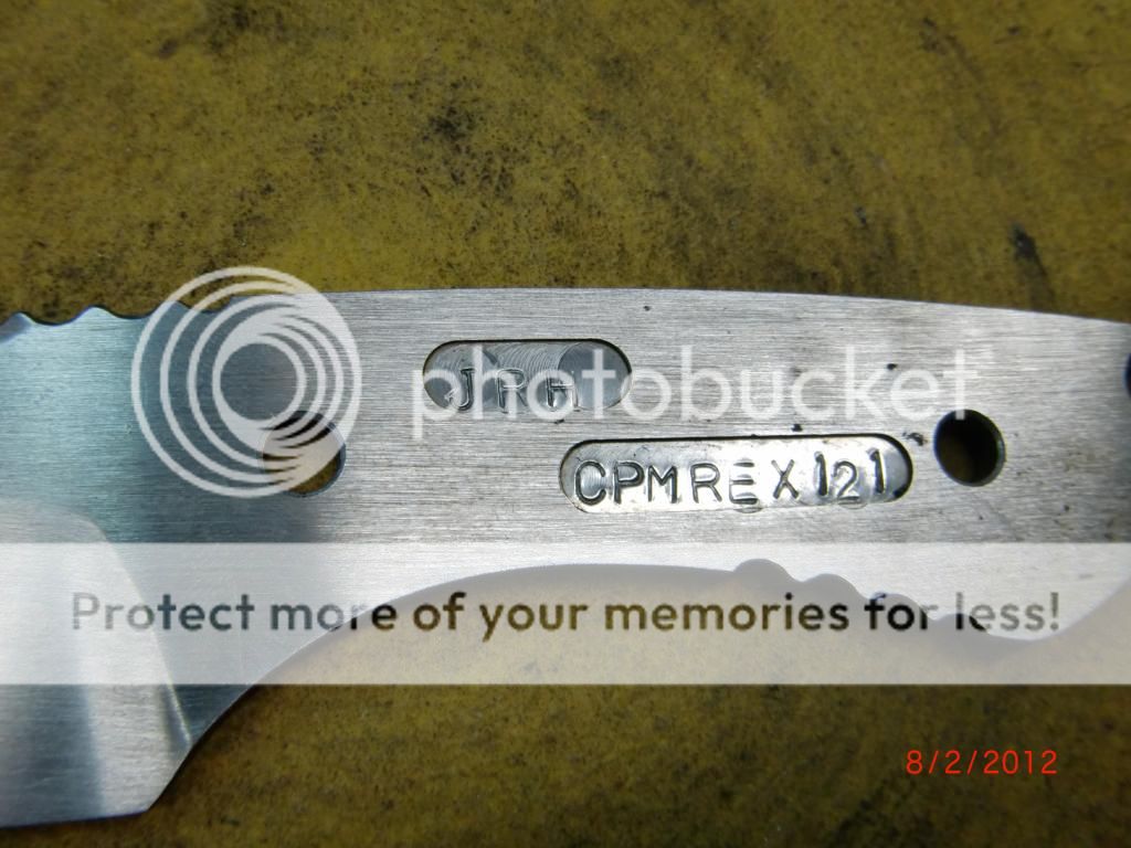

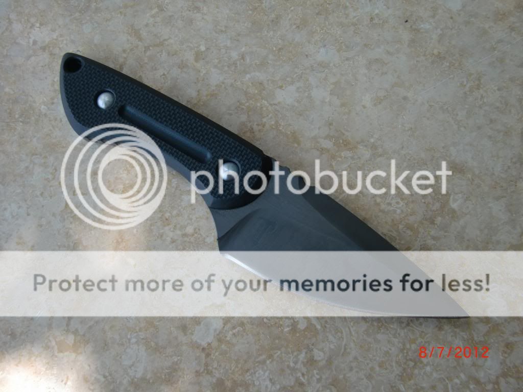

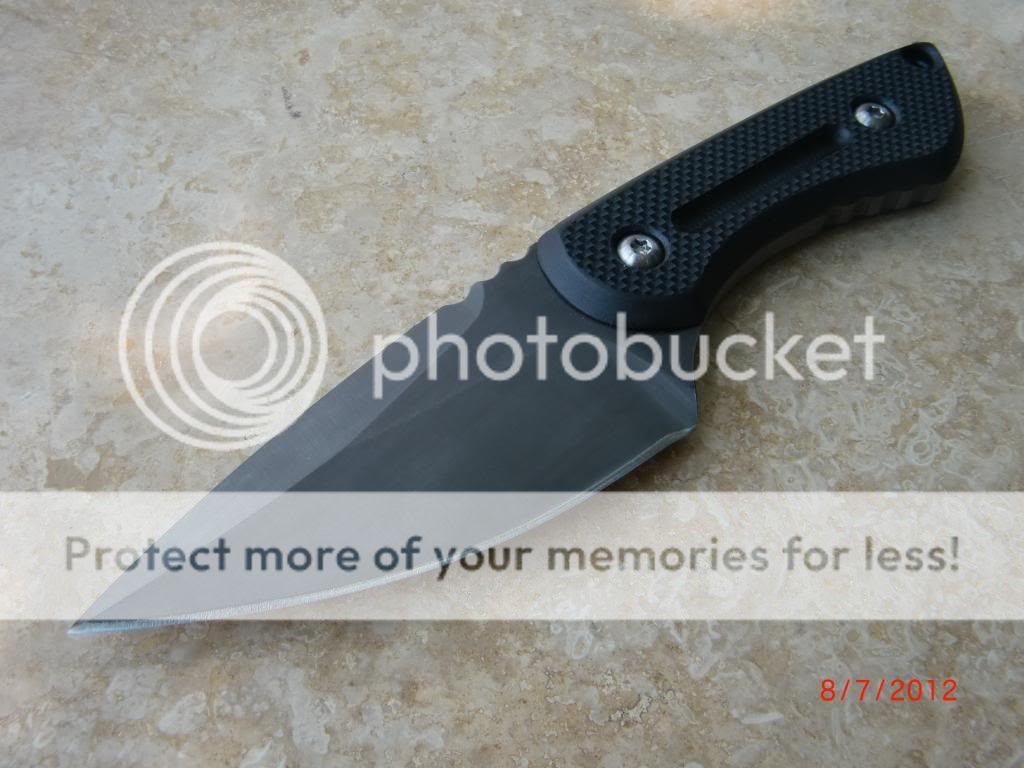

I got a good sized piece of CPM REX 121 a couple months ago from Aldo (NJsteelbaron) I dont know how much he has now as he only had a sample piece. I build this knife a month or two ago, just now getting to the pics and vids, lol. I sent this off to Aldo and Pete Bruno for some testing and I just let them have it. They have a vid on their facebook page of chopping a 16 penny nail in half I went out and abused it and broke a bit of the tip off by sticking it in a tree and prying it sideways real quick. Im impressed with this stuff, as only a little portion of the tip broke and the tip was very pointy! I re-profiled the tip a little stouter and tried again with no breaking. I took a couple of pics for a short WIP

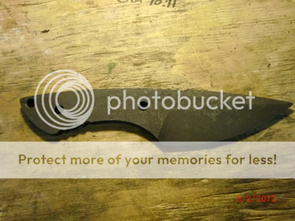

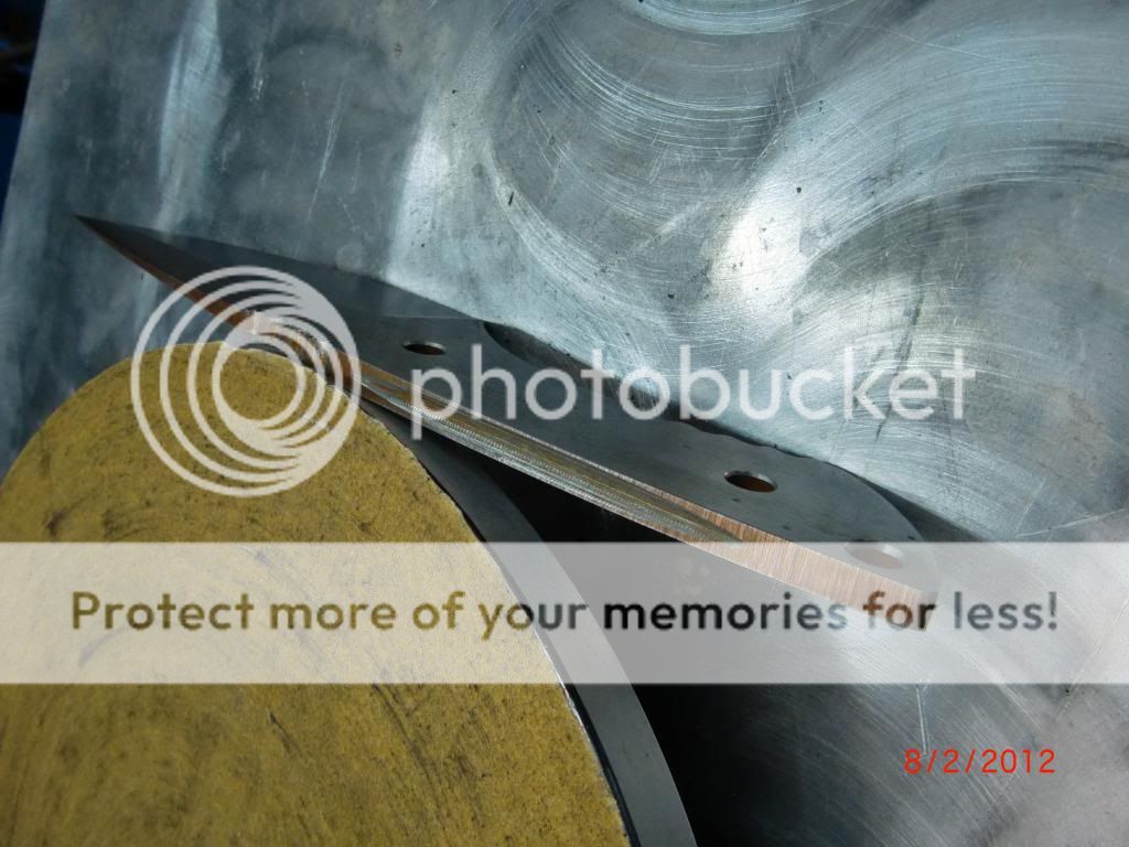

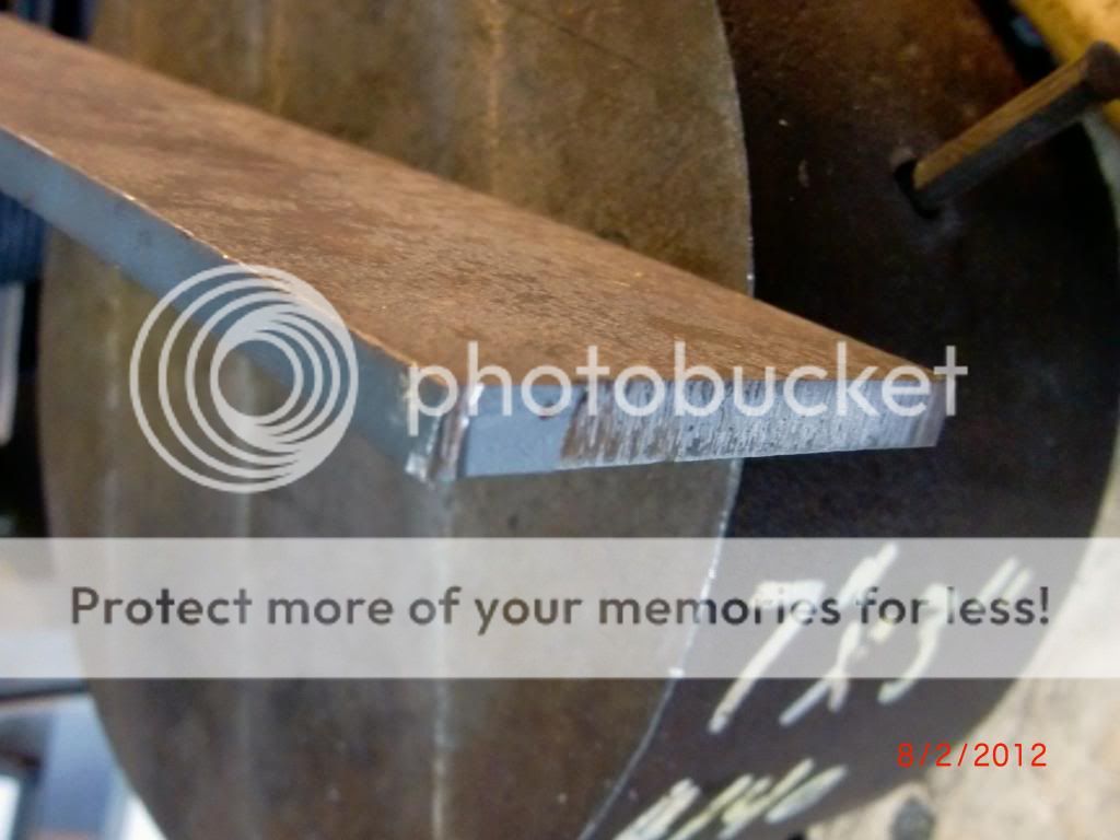

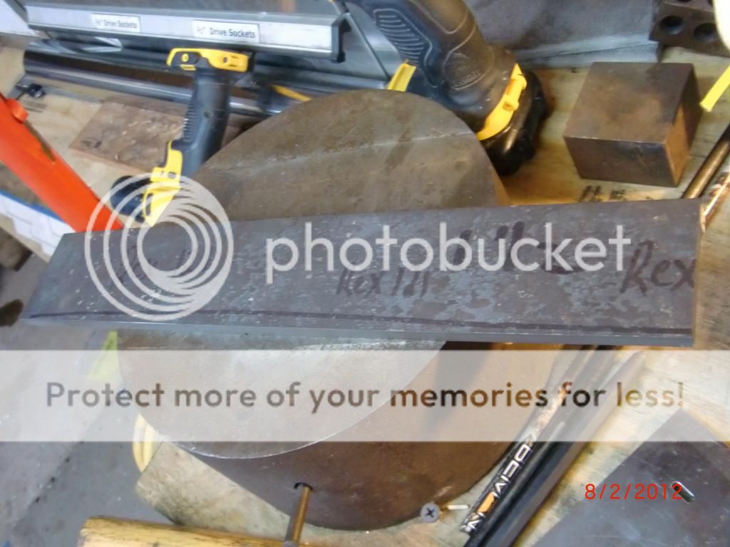

I didnt get as many pics as I would have liked because I was cussing at the steel trying to cut it into a profile! It will not cut with a bandsaw annealed. It will also not cut if it gets red hot.
I found the best way to cut it was to score it with a cut off wheel and break it with a hammer

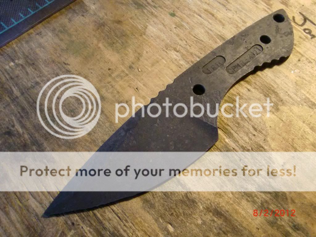

Right outta heattreat

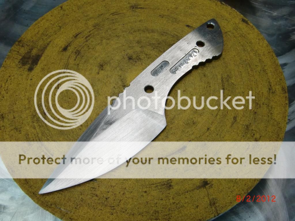

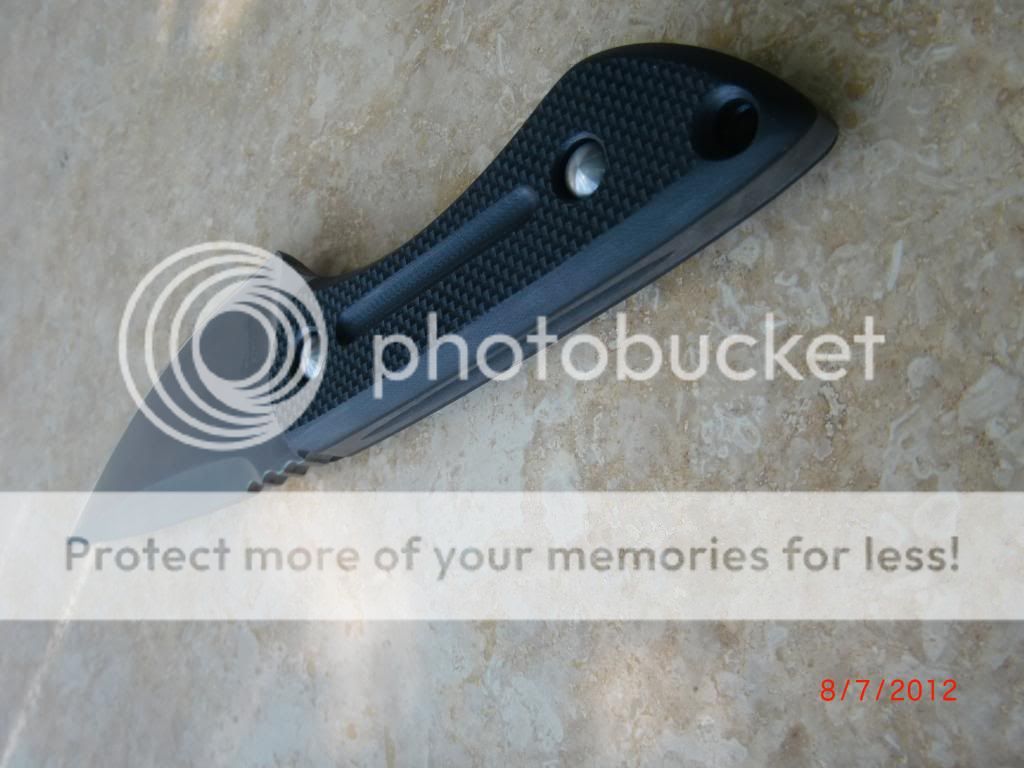

Hand sanding, dont bother its harder than your sandapaper!!!

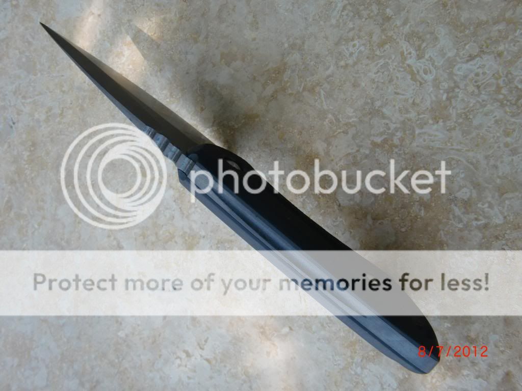

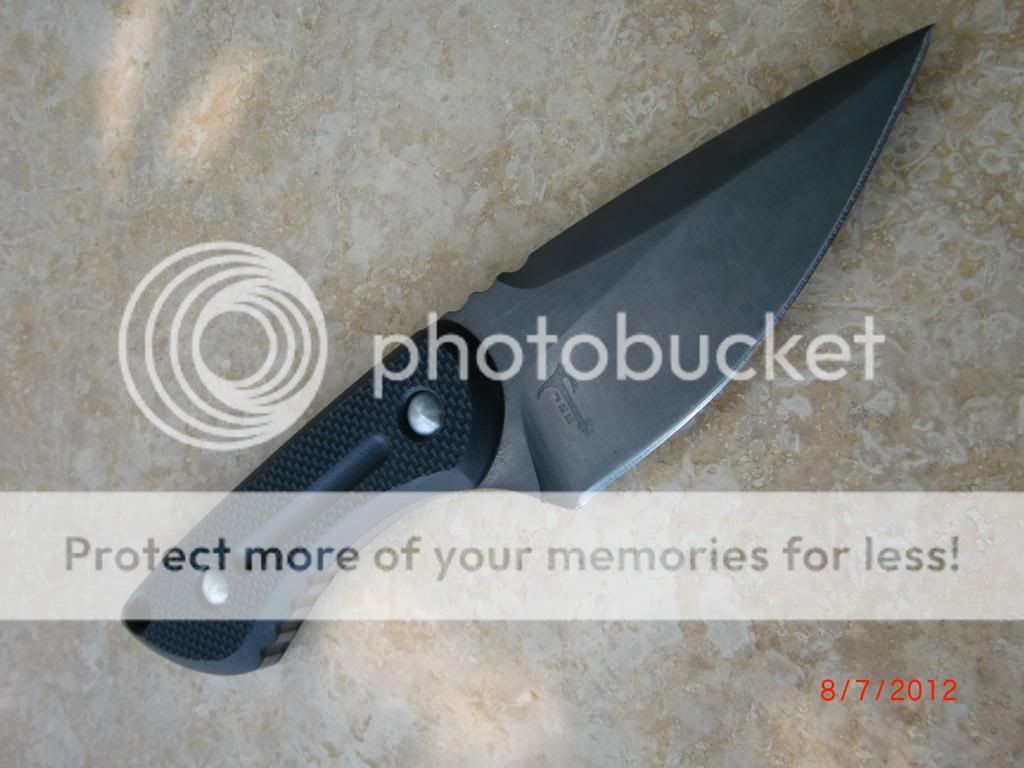

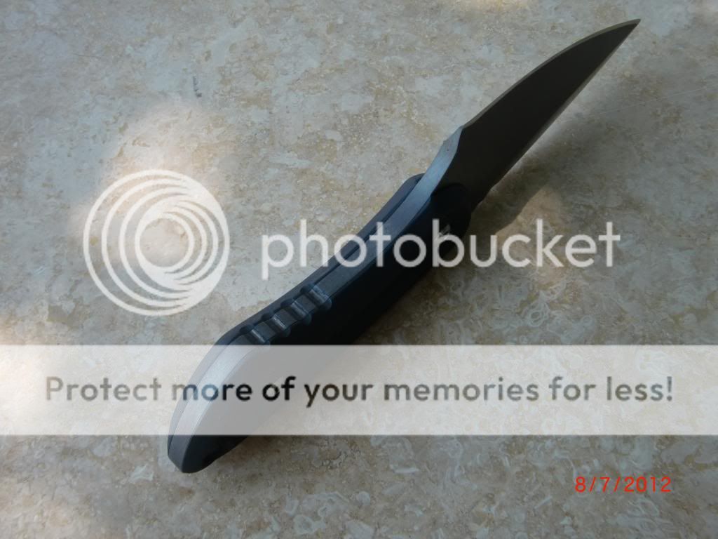

Finished up and sent to Aldo and Pete for testing!
rex121 is a great cutter, but prying? Not surprised it broke the tip.. the stuff is brittle.. edge holding, not chopping steel :D
That knife looks great... And like 1shot, what are the specs?? Thanks! Oh and will you be offering these in rex with a slicey grind? Thnx much!

I have a couple of the mules made by Farid and I have been surprised by this steels thougness given the Rc of ~69. It has seen a drop onto a tiled floor only missing a very small piece from the tip and has been treated rather badly in general with little to moan about.

Nothing in hand except for in the vids. It is a 4.25" handle and 4" blade. Fairly small fixed blade. It was fun to sharpen!
I may do a couple one offs in this steel, but it will deff be from a waterjet batch! way to much time in profiling them to make it worth while to make more than one, if not.
