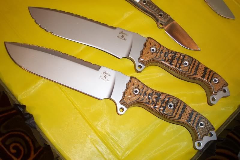

Maybe this only adds to the confusion, but here is the description of the Flying Nuclear MOASH from the big man himself.
“…They feature Tiger Hide grips, a recurved blade, and "flying" angled serrated teeth along the forward sweep of the cutting edge.”
Here is the picture sent in the email.

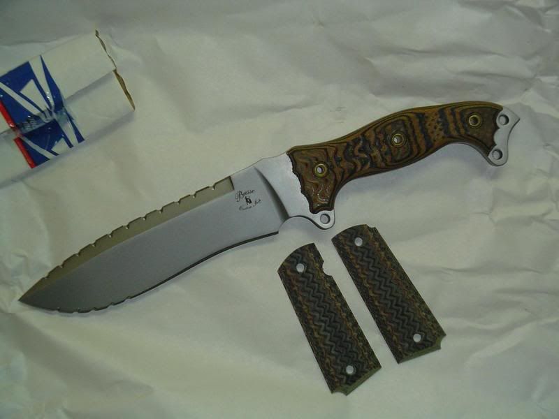

Here are the pictures supplied by some of the piglets :D that scored one of these beasts.

To me the "hide" and the "skin" look the same. The only variation I see is that some of the tiger looks a good deal more tan and some looks to be more of a red brown, but this might also be dependant on the photo editor they use. I know if I monkey with mine in the wrong way, handle colors can change.
Here is a pic of my NuclearMOASH next to a HOG's FlyingNuclear, with the Tiger Hide, just to add another pic for the sake of reference, still doesn't quite answer the question though...

OK fellas lets see if I can clear this up.
The correct term is Tiger hide. However the item in question that is being referred to as Tiger Stripe is in fact the same material as Tiger Hide.
Tiger hide micarta is essentially a layered canvas micarta containing black canvas, a tan colored canvas and resin. Now here's where it gets tricky. The tan canvas, with age, can darken. So we can see a variation of tones in the tan canvas which is what is causing the confusion. All tigerhide micarta starts out the same way.
Also as Progunner pointed out, by oiling the handle you can darken the material, and to throw another loop at you guys, I have found that different oils will also produce different shades.
Tigerhide, like any other multi layered material, can and will have varying shades of color. We have the same thing with our snakeskin micarta. With age, oil and depth of grinding or machining you will get many different variations.
This all adds to the mistique of these materials as every knife truelly has its own special look.
I hope this helps clear a little bit of the confusion. Of course I may have just made it worse.
Anyway to sum up this post, Tiger hide and Tiger stripe, as it has been called elsewhere, are the same material however appearance of said material can vary.
