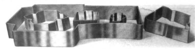

I know someone here knows the answer to this one! Hey guys I have a weird question so please forgive me if this is in the wrong section and will the mods please move it...I have a project for school, and am hoping I can figure out an easy way to go about filing a certain steel. And, I figured I would ask you guys because you have given me great advice in the past and you guys know the most about saw steels, and the like.
I need to choose a steel, to make a punch out of. It will be a circle punch press, and the diameter of the hole needs to be 3.25". Now, at my local hardware stores, they sell this diameter hole SAW bits, and Im wondering if I can just go ahead and file the teeth down to a flat surface? I am only punching through plastic sheets no thicker than a few sheets of paper, but i need to do thousands of them. I could always have the option to resharpen the ring punch if I need also, thus why I am wondering if one steel is better than the next as I need to keep the ring sharp as to not punch sloppy holes. Now, is this possible? or would I need to somehow soften the steel then harden it? Or, is there a better way to go about this? But, I am working with a very small(almost nonexistent) budget, and would like to do this myself if possible. This is my first time building something like this, so any and all help would be greatly appreciated. So, thanks for your patience everyone, but could someone possible point me in the right direction? any links or ideas?
Is there a certain type of steel that i could use for this just by filing a pipe or hole saw bit into a sharp edge? Then of course, I would secure this to a vertical movement application of some sort to work as the press, much like a drill press. So, again thanks for your patience and help in advance.

Buy the hole saw and cut a hole through two layers of 1/2" plywood. These will be your dies.
Grind the teeth off on a bench grinder or belt sander Don't overheat the metal) and then lap them smooth and flat on some 120 grit wet-or-dry sandpaper laid flat on a flat surface. Take the surface up to 400 grit when you get it totally flat. Use a granite surface plate if you have one available. This is your punch. The smoother and flatter the edge, the better it will punch. The outer edge must make a sharp angle, as close to 90 degrees as possible. Now, use a rotary stone in a dremmel or similar tool and taper from the inside edge toward the outside edge, making a sharp edge. This is the cutting edge.
Put the punch in the holes of the two plywood pieces, thus aligning them. Slip some strops of 1/8" wood between them to space them apart, and glue a strip of 1/8" thick wood between the two die pieces along the back edge. This will leave a space that you can slide the plastic in and punch it.
Slide several sheets of the plastic between the dies, and cut down with the punch. A drill press ( not running) will probably be fine for applying the pressing force.
Bladsmth has it down mostly. You would basically be making a steel rule die. here is a pic of one.

I wouldn't mind toying with the idea of a design like in the pic above also. Is there a certain steel that I would need to use for that?

Yes, if possible a metal die would be better, but making one in wood will be simpler. A piece of hard and smooth material, like Corian would also be a better choice than plywood. Check with a cabinet shop or place that does kitchen counters and they will give you a scrap piece.
You had said there was almost a zero budget, so I was going with cheap vs best. If the hole saw is a metal cutting saw ,you could cut the bottom die ( the top one is for alignment ) in 1/4" steel. If the hole saw is one for cutting door lock openings in wood, it won't cut the metal plate. It will cut the Corian, though.
You can customize the slot between the upper and lower die to conform to your material. The 1/8" was for basic explanation. The spacer strips can be placed as needed to make the die assembly hold up. On re-thinking my post, I would suggest placing a spacer strip on opposite sides to allow the plastic to be inserted from the front, punched, and pushed out the back by the next piece inserted. This would make the die assembly more rigid,too.
There are lots of ways to flatten the saw edge, and make the die, but I figure that you can devise those changes to fit your need and ability.
BTW, save the cut out circles of wood and place them in the punch to fill the hole up to nearly flush with the edge. Otherwise, the disks may get pushed up into the punch instead of dropping out of the bottom hole of the die.

Okay, and Im thinking more about a custom shape punch and die now, much like the one in the picture above....So, any ideas on what steel to start with? Again, thanks.
Dave
They are called Steel Rule dies for a reason.
What are you trying to do now? If you include a sketch I can help out a bit more.

I'll be straight forward about this.
First you wanted to punch simple circles. Now you want to punch a complex 8 segment pattern. Such a punch and die will cost several thousand dollars on the low end. The press to opperate it may cost as much to build.
What exactly are these plastic pieces going to do?
I agree it is getting much more complicated now.
If you wanted a few, I would say, just get the item waterjet cut.
