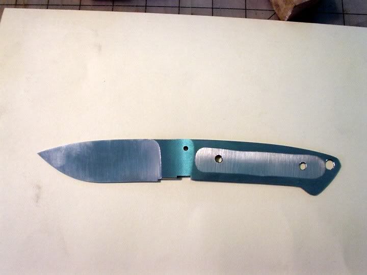

I mostly hollow grind all my blades. Like Stacy said just start the grind at the edge and work it toward the spine. I use any where from a 5" wheel to a 14" wheel. I seen the calcuator but have never used it. I like a smaller wheel because it leaves a sharper ridge especially for double edged blades.
This knife is done on a 5" wheel starting at the edge and flat grinding my way all the way to the top:
