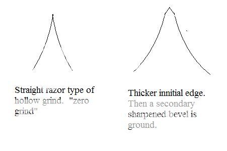

This was very well said. A hollow grind doesn't necessarily need to be "thin" relative to the blade thickness. If you look at some knives that have an unsharpened swedge, they are often hollow ground swedges without a secondary sharpened bevel. For example, a 1/4" thick blade can be hollow ground and left with 1/8" edge thickness before the secondary sharp bevel is ground. It offers a good marriage of weight savings from the hollows and the strength of a scandi secondary bevel.
You can also hollow grind all the way to a "zero" edge leaving the edge at almost an immeasurable thickness before the secondary bevel. Straight razors have this kind of hollow grind. They slice and cut much more efficiently but battoning with a straight razor would most likely result in edge deformity because it is so thin at the edge.
Here's what I mean by two different types of edge thicknesses with hollows:
