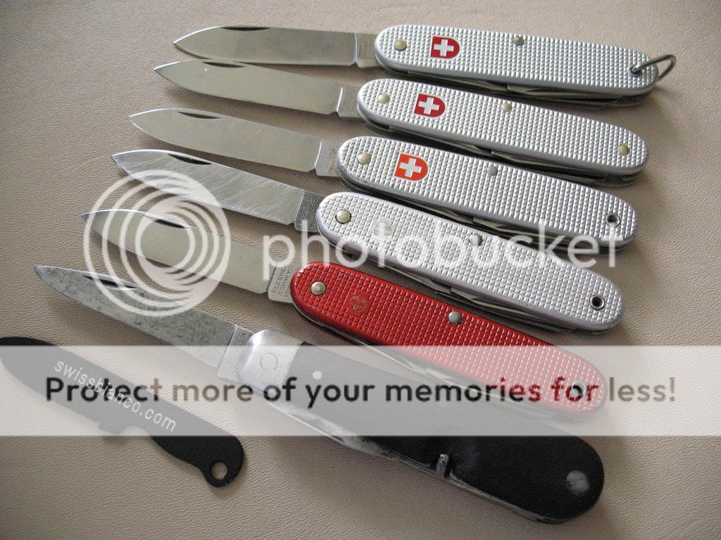

some different 61 sak over the years:
later, the wk stamp was gone cause there was no need to check each single sak as the quality was way good anyway. the hollow rivet was gone cause the granade mentioned was no longer used and the new ones had an different sight. only wenger did still make some with hollow rivet with bail as on the pic. there was no swiss army issued soldier with splitring on them. all swiss army soldier have an yearstamp on the bladetang. starting with 61 to o8.

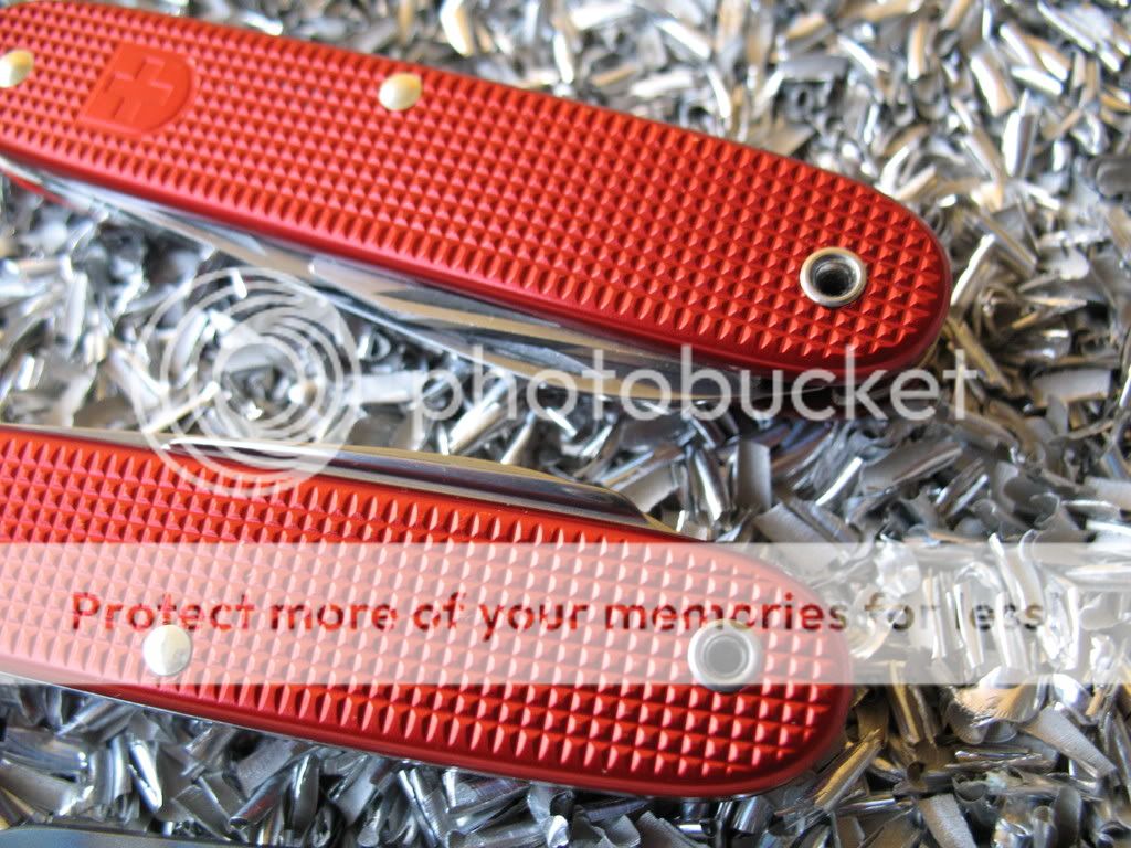

victorinox did not made any hollow rivet sak for an verry long time but an happy swiss was able to get 10 pcs made, the verry last made soldier, complete red anodised as the first run, o8 blade yearstamp and some old tools used, theyr long gone too

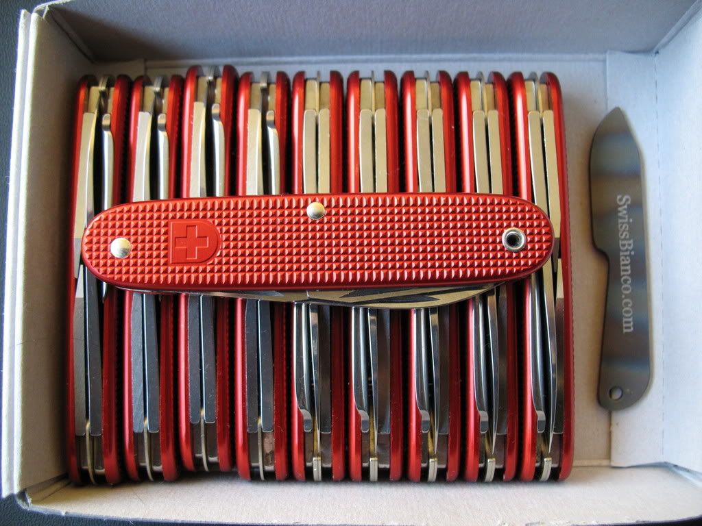

My goodness - those all red, old style cross, with the hollow rivit, are just fantastic looking. I'd like a couple of those for sure.
Roger - you need to create a special run. And one of the black, red shield, Swiss Railway grails, so the rest of us unlucky folk that missed out can get a newer reissue, even if they aren't the first limited run. With your logo so as not to devalue the collector ones already out there.

Wonder what the reason the hollow rivet isn't used anymore as it would benefit as a lanyard hole while also opening up a slot for another implement.
What's that little fixed knife at the end?
