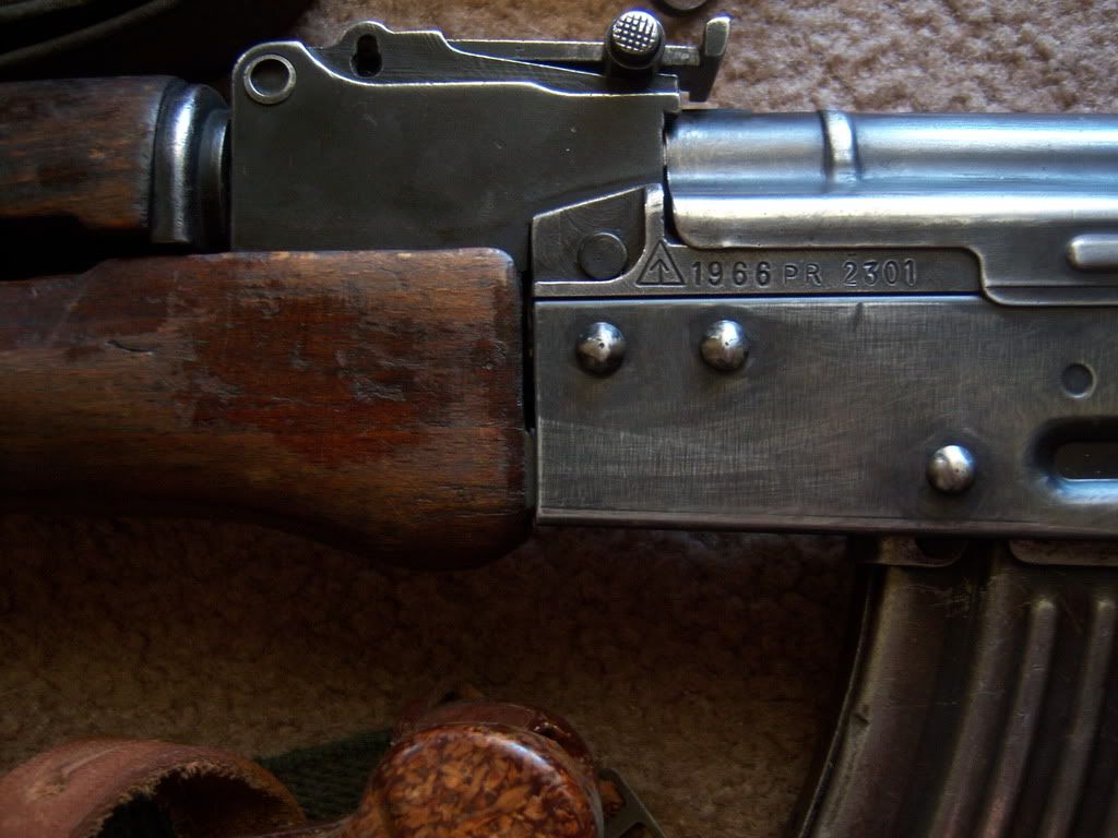

I picked this job up from another form. Apparently The last owner was a real butcher and managed to distroy 70% of the parts in the kit including the barrel, trunion, and rsb. I opted to cut the old rivits off and do a weld build. Got the first kit for $115 shipped. I then picked up some replacement parts that had some character and a replacement parts kit to finish the build.
The second parts kit will be here by the 17th so I've only been able to go this far so far.

It's actually not that bad, the reciever is a nodak 100% and the barrel is already headspaced to the bolt.
The easiest build to do is a weld build, If you can find a matching numbers parts kit or a kit thats already been headspaced like mine all you have to do is slide the front and rear tunions in to the reciever, clamp, then weld. It only takes about 30 minutes to do and 25 of those are waiting for each weld to cool before you make the next weld. I would be done now If I had the barrel assembly from the second parts kit.
I wish I had one of the welders where I used to work, I could do a much better job. That welder I'm using is a 110v $80 craftsman rig I bought used off of craigslist.
This is going to be a "red dawn" urban resistance build, something somebody could build with a pile of spare parts and a welder in there basement. I've always liked the look of a been there done that gun. When its done I'll plug the barrel, coat the inside with RIG grease and chain it to a tree next to my creek until it rusts solid.

I'll pass on a screw build, they like to work themselves out over time. That rear trunion lets go and you will get a bolt to the face. I always hear people talking about how easy they are to take apart incase you have to replace something but for the life of me I cant figure out what you could break that would require the removal of either of the trunions.
The only thing screwed togeather on mine is the trigger guard. They were all loose and one was missing its nut. I thought about removing them and welding the trigger guard but they look so much like rivits I figured it would look cleaner if I just welded them from the inside.
On another forum somebody tried using u drives. The guy swore this way was just as strong as using rivits, I think he got about 3 months use out of it before the trunion let go while he was firing from the hip, the bolt carrier ripped his wrist open and he nearly bleed out at the range, had to be airlifted to a hospital. I welded the HELL out of the rear trunion on the inside, its NOT going anywhere lol.
