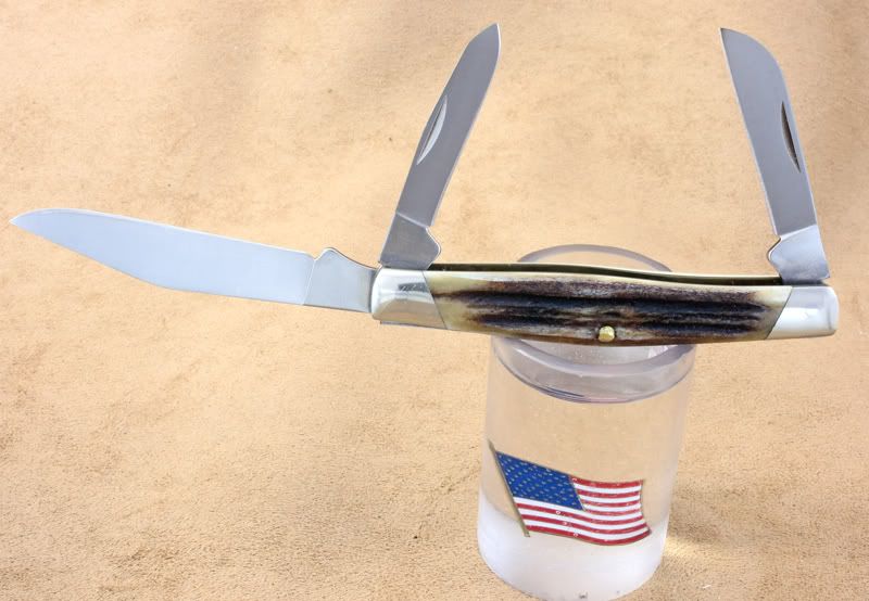

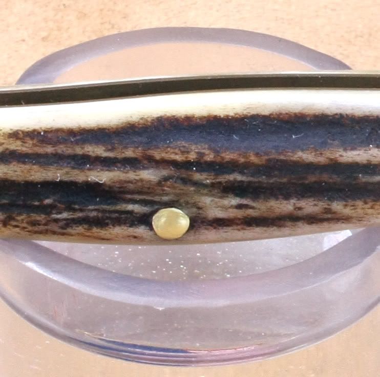

I bought a knife on the spur of the moment, that I might have passed on if my head had been out of my.....oh well. It was a 1988 303 in stag which was good stag but had been trashed, in a sense, by the factory. Both rivets had multiple strikes that jumped over on the stag itself. See photos below.
Full view of front side.
Front side rivet:
Reverse side rivet:
Its 1988 there is not much factory help can offer. So OK, I will give it a go.

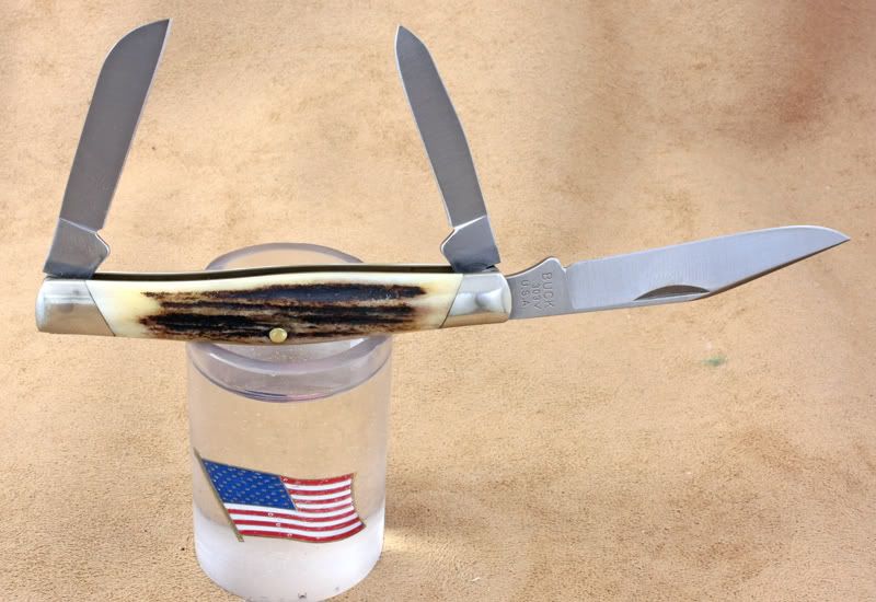

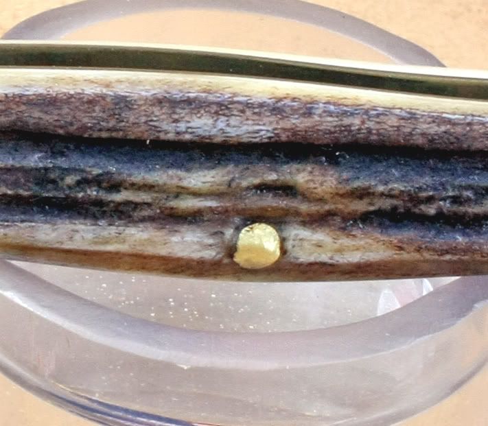

I carefully and I mean carefully, used a dremel on low speed and tried to semi-artfully blend the stamp press marks into the stag. I also very VERY carefully used a sharp pointed bit to grind off the smashed rivet edges. At some point, not being expert, I feel you have to say : enough is enough and I will regret going on in the attempt at perfection. So here are my results. Haebbie wanted to see them so here you are.
Front side view:
Front rivet close-up:
Reverse side view:
Reverse rivet close-up:
The rivets could stand a little more polishing, and I am thinking it over.
What I would say to everyone is, if knife is in hand- really look it over carefully. And if you have the right tools and think you might fix something, go really, REALLY slow and don't make things worse. If I had just bought this knife it would have gone back to factory, if it was a high dollar old knife it would have gone to Eric or Leroy. Slow and steady wins the knife race.
