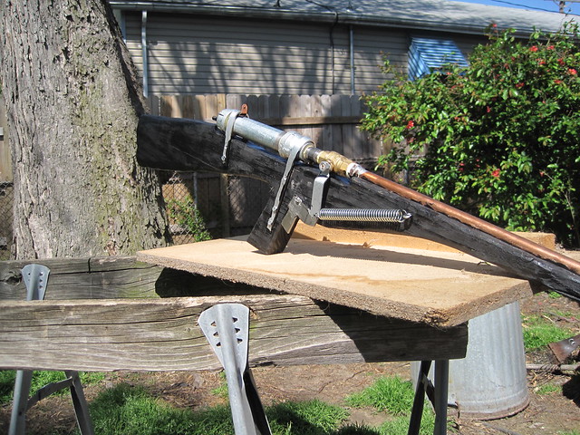

Finally got around to putting together version one of my airgun:

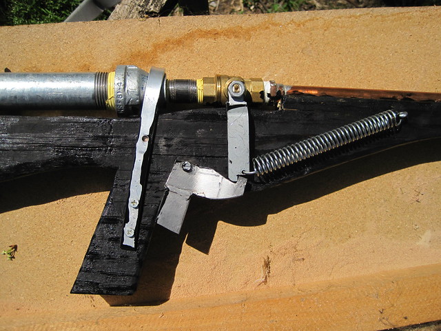

Close up of mechanism:
Pretty crude, but it's mostly a test-bed. Simple ball-valve action, the ball-valve is opened by the spring and the trigger retains the ball-valve's arm.
I pressurize the air chamber to about 125 pounds with a few strokes of a bike pump.
This is a simple design, but quite effective; I've been shooting 1/2" marbles and they come out with authority. Whizzes through several sheets of drywall...
I plan to get some .45 lead balls and try shooting them patched.
I intend to build a more-potent and more efficient reciprocating-valve model, but I need to accumulate some plumbing parts.

The reciprocating-valve assembly seems to be the most efficient idea in current use; it's also called a "piston valve". Took me a while to figure out how they work, but it's essentially pretty simple. The piston seals the bore from the main air charge, and communicates with a small air chamber to the rear which is trigger-controlled. When you activate the trigger, that small supply of air is exhausted, forcing the piston to the rear to allow the main charge of compressed air to go down the bore.
