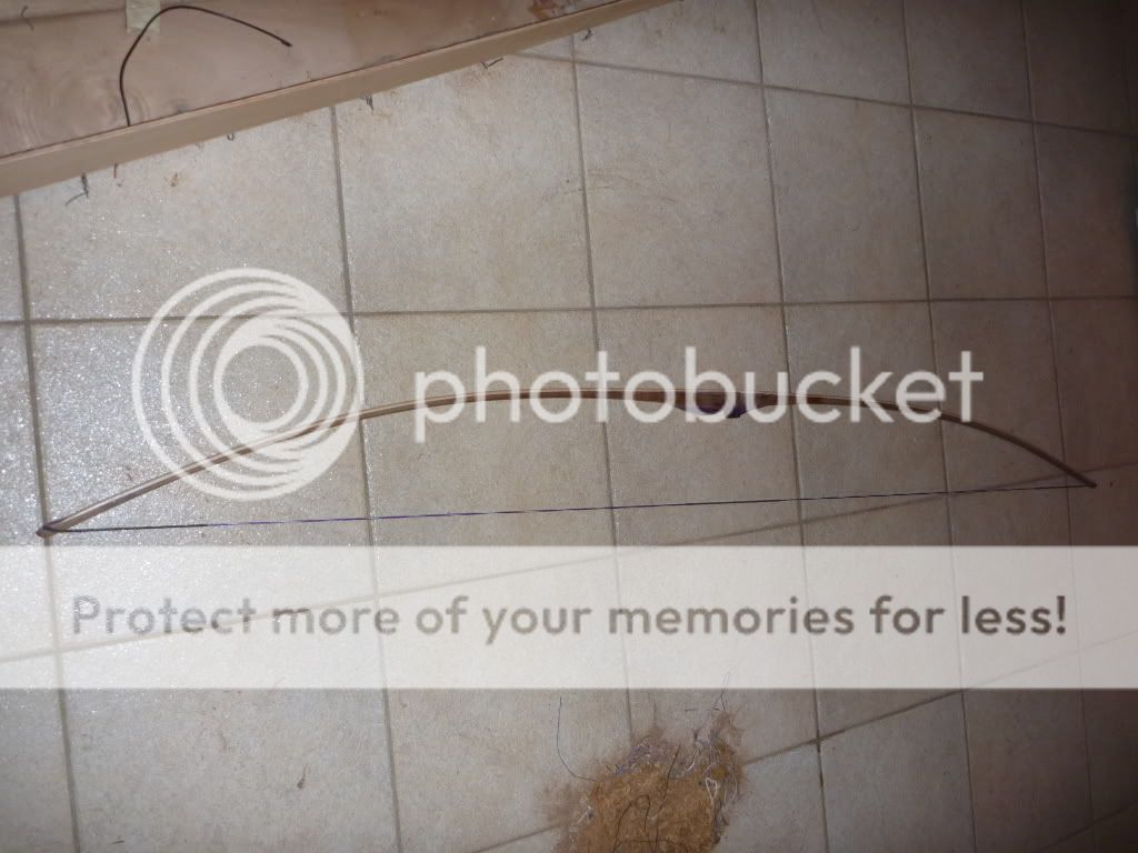

I don't have any good pictures right now, but there's enough to give you the idea. Some day I'll get a couple of good shots.
I made it as a gift for a friend who is fond of purple (she was holding it the other day while wearing a purple shirt and with a streak of dyed purple hair the other day and matched the bow quite nicely

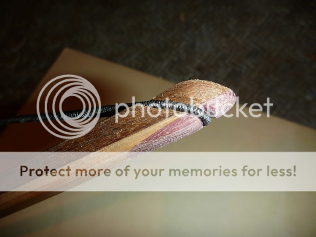

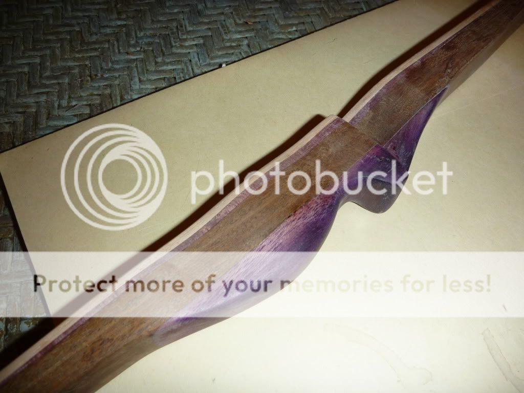

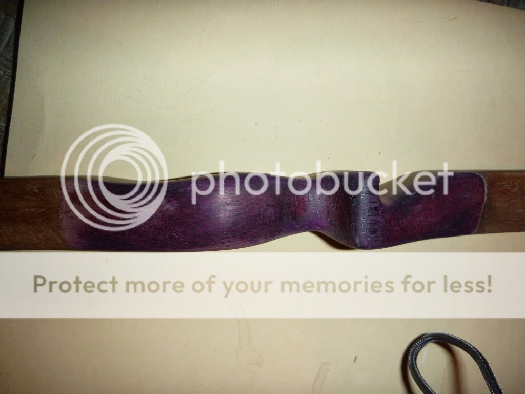

). Made to her specs, RH, 26" draw length, 32#. I believe the bow is 70" ntn. Ipe belly with Hickory backing. Purpleheart power lam, handle section, and nock overlays. The bow has not yet had a finish applied. The purple color is natural (kind of, anyway, I used a torch to accelerate the oxidation of the handle piece a little bit).
It's a sweet shooter!
