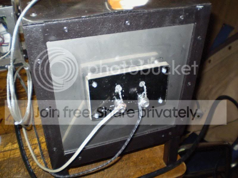

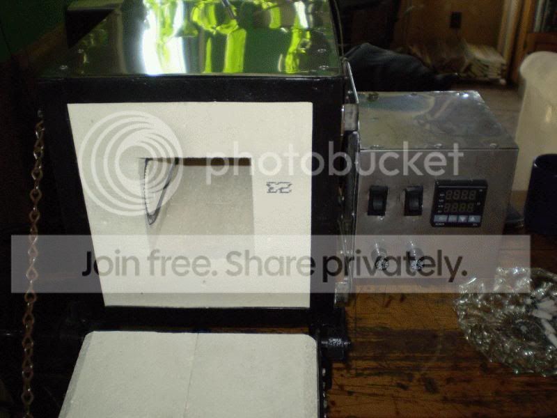

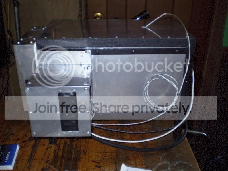

I finaly got my new oven finished so here are some photos.
It is made from the plans that where on British Blades but i made a drop down door like the paragon ovens.

I would add a cover of some sort over the heating coil wire connections.
Thanks guys! Stacy i plan on making a cover for them and a wireing harness to keep the wires safe as well as me.

Bob - nice work, did you use a pre-wound element or did you wind the kanthal yourself? Have you run it up to temp yet?

I bought the element from duralite prewound i just had to strech it. No i was going to get it running yesterday but i decided to wire in a 20 amp receptical for it so i will get it going today.

Looks great Bob! What are the dimensions of the chamber?
Thanks Pat the chamber is 4" x 4 1/2" x15" a little smaller than i was planning on but i had all the material here for this size so i went with it. I usualy only do one or two knives at a time so it is lots big for me.
