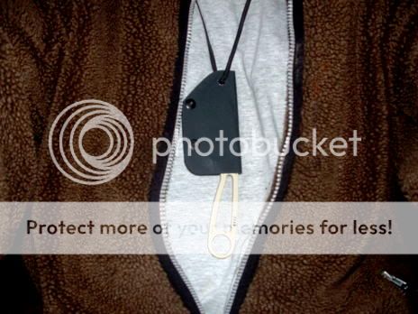

I bought a square of Kydex to have a go at making a sheath. This is my first atempt with limited equiptment, so please dont laugh too loudly.

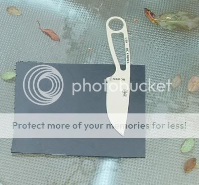

Firstly I roughly cut a piece of Kydex big enough for the job.

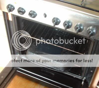

Cooked until soft enough to manipulate. (I used leather motorcycle gloves to handle whilst hot)

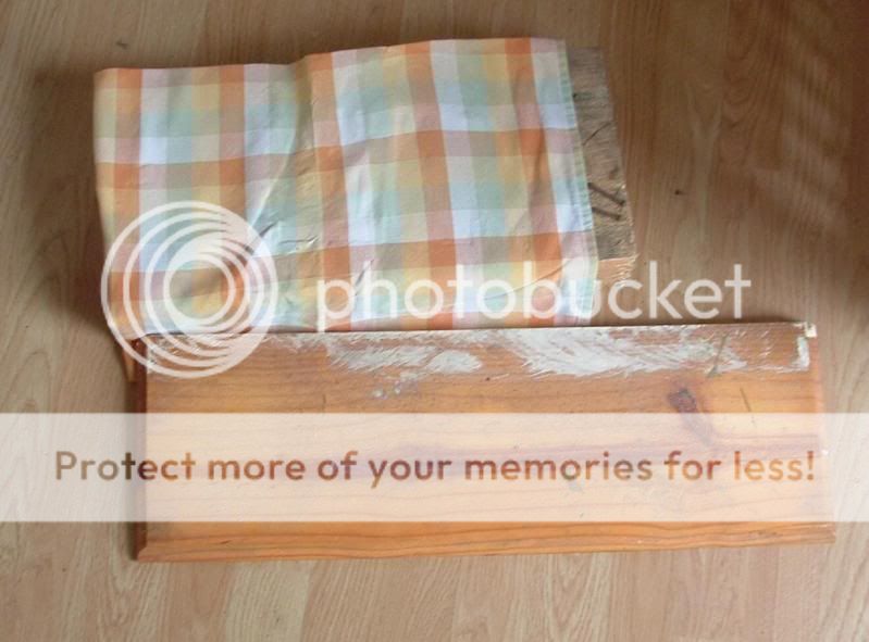

Out of the oven and quickly wrapped aroud my Izula then into my improvised press. (Two pieces of wood and a cloth)
Popped the hot Kydexand knife into the folded cloth then between the two pieces of wood and applied pressure by standing on it:rolleyes:

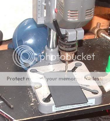

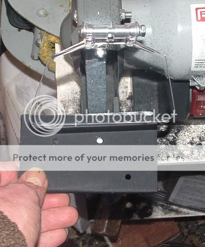

Drilled out holes for screws and tekloc if required. Also drilled a hole for a rivet for neck chain carry.
My small bench grinder was then brought into use to roughly shape the sheath

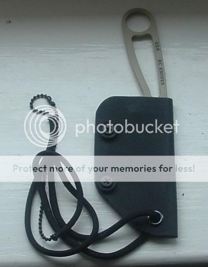

Screws and rivet fitted, and I dont think it looks too bad for my first go. The knife fits with quite a reassuring click and when the screws are tightened fits firmly with no movement.
Minor touching up and polishing the edges to do as and when. Its slim and very light. Im quite pleased.

Good job!
A few words of advice if you plan on doing some more. Get yourself a peice of the blue camping pad from Walmart to use as your press foam. It's 5 bucks and works great. I got some of the professional pad from a kydex supplier and quickly went back to the blue stuff.

You did one hell of a job for your first time and using improvised tools!!! Two thumbs up. It looks really good.

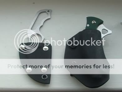

Another couple made since my first attempt. Spyderco Swick on the left, and Cherusker Messer Lapu Lapu Corto Military model on the right.
