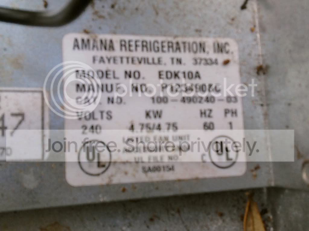

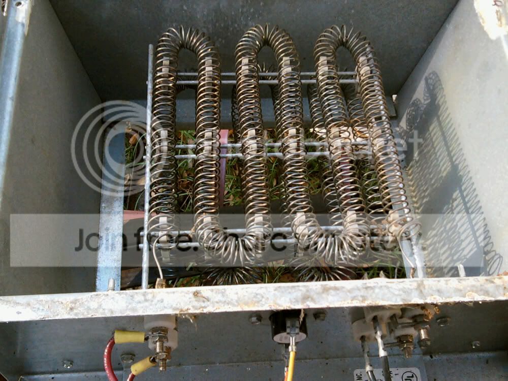

Now here is the crazy part. I pulled an electrical furnace out of the trash and stripped it down for scrap. I kept the heating coils from it. There are two sets of coils. Each one uses (or needs) 4.75 KW of 220 power to be used as a furnace. If I was to take them out and put them into a brick made cavity and then get the temp control unit and get it hooked up properly, think it would work? The coil pack has a shut off control set to about 100 deg or so. If that is taken off, wouldn't it just keep getting hotter and hotter until shut off or over loaded or something? Would a PID unit work for temp control? I'm pretty much electrically challenged, so I would definitely get some help if I ever decided to try this. Just thinking out loud I guess.
