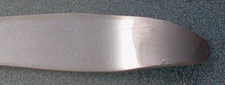

Thought i would share in a short post. I prefer knives to ride low in the pocket. Bought the Leek 2nd hand on the cheap to be a user, so shelling out for a custom fabricated, unobtanium coated, forged in Mordor clip was not in the project budget, which was exactly 0 dollars. I took one of my OEM Leek pocket clips and got creative with some pliers and a blowtorch. The overall goal was to bend it over itself and reshape the bottom to clip without snagging. Sanded with the grain a bit to smooth out any tool marks. While the end result is certainly not for a showman's knife i was pretty happy with how it turned out. Enjoy some pics.
While the knife is discrete the clip still kind of glistens thereby defeating the purpose. Hoping to run across a handy sand or bead blaster for the knife/clip to dull it up a bit. Another day i suppose...

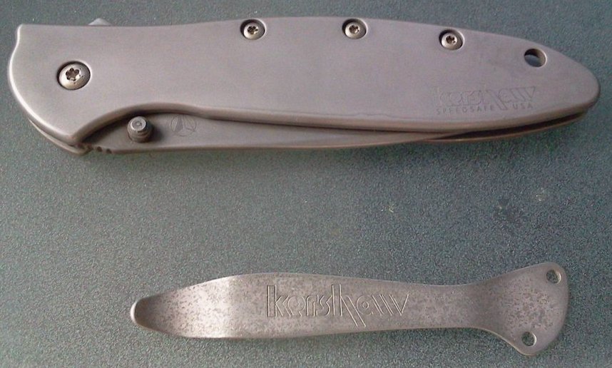

I didn't mean to do the back side of the clip, but some of the etchant snuck over. That kind of shows the difference between the factory finish and after (but you could make it darker if you wanted)
I hit it with a carbidizer awhile ago (makes it grippy), so it appears mottled. I threw the knife into the pic, darkened the same way but not carbidized, to see how it would look without the carbidizing.

Thanks for the feedback guys. Managed to give it to a buddy for a little sand blasting as i was wanting something a little more matte than the brushed look. Took it apart with the blade closed (tension on the spring).... SpROiNg... cr@p everywhere. No big deal though. Tracked it all down. I'll get some pics up a bit later.
Before:
After:
You can still faintly see some of the scores from the earlier brushed finish but it came out pretty darn good. Might throw it back in for a heavier grit to make it a little more textured but i am happy on how it came out. I might even try using that PCB etchant that you guys mentioned earlier to darken it up a bit, but for now i took the shine off it which is exactly what i wanted.
