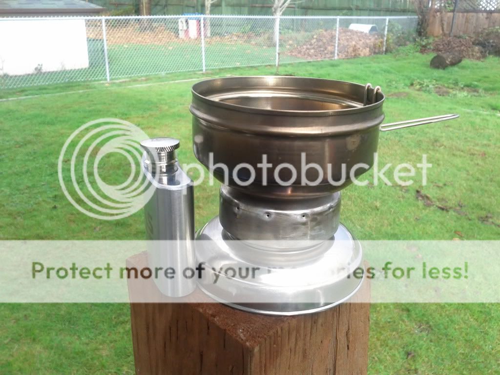

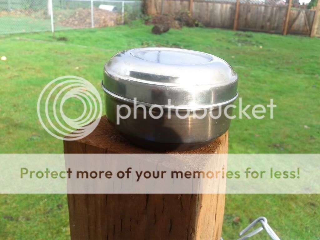

This is the stove i made. Used 2 pop cans and sourced the pot at a dollar store, made the handle from some rod laying around and the flask is for the isopropynol fuel. It all fits inside the pot and it will boil 1 cup (250ml) of water in 5 mins. It's more of a survival stove. Here's the pics, sorry no action shots.

20 min boil time? Seems a bit slow. My alcohol stove boil at 6 mins, my Northern Lights Ti brings it in at 3 mins.
But, that is a cool ass design.

The time might be less it was like watching paint dry. My g/f had my phone/timer
Gotcha.
I think, as most material stoves go, I would guess about 8-10 mins max.
Like I said, I love that design. And good work, BTW.

Thanks Moose I wanted a survival stove and didn't have the money to buy a cool one
