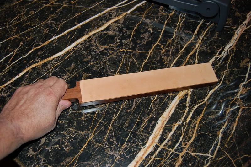

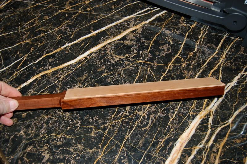

I hope this is the right place to put this.
I decided to make my own strop today. I make wood boxes so I have rems of really nice exotic wood and I thought I might as well do something useful. It was a rem, I think it is jatoba wood but not sure.
Overall length 15"
leather strop 11 1/2 "
leather width 1 5/8"
It is working really well, I think I will make a cocobolo next.

But I strongly advise AGAINST a double sided strop. There's just too much danger of contamination for the side that is down, unless you're using it on a table that's surgically clean! IME, single sided strops are the best way to go.
Ben has an interesting point... it wouldn't work for a paddle-shaped strop, but if you have a big enough chunk of wood, how about putting the leather on two adjacent sides, so that the one on the table is always plain?
