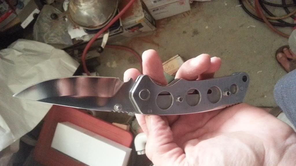

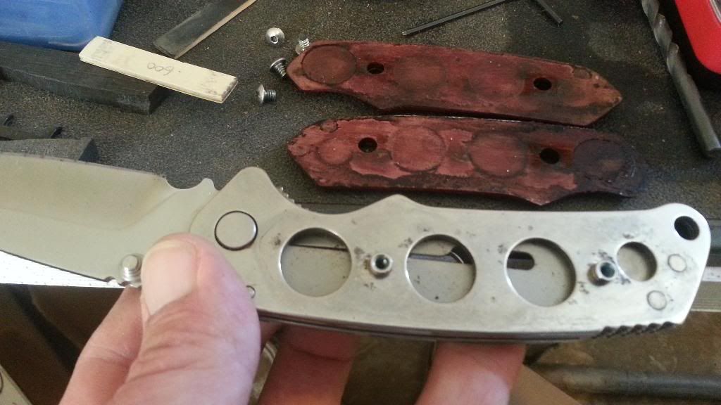

OK, Scored this off the Bay.
277 Alpha Folder with ATS-34 and no sheath.
It needed a lot of TLC which I was happy to do.
Dymondwood was severely bubbled, and I am not sure what would do that.
Then there was a bit of corrosion, and she was a little dirty.
The pivot action was a little rough too.
The scales were pretty dirty etc, on the underside!

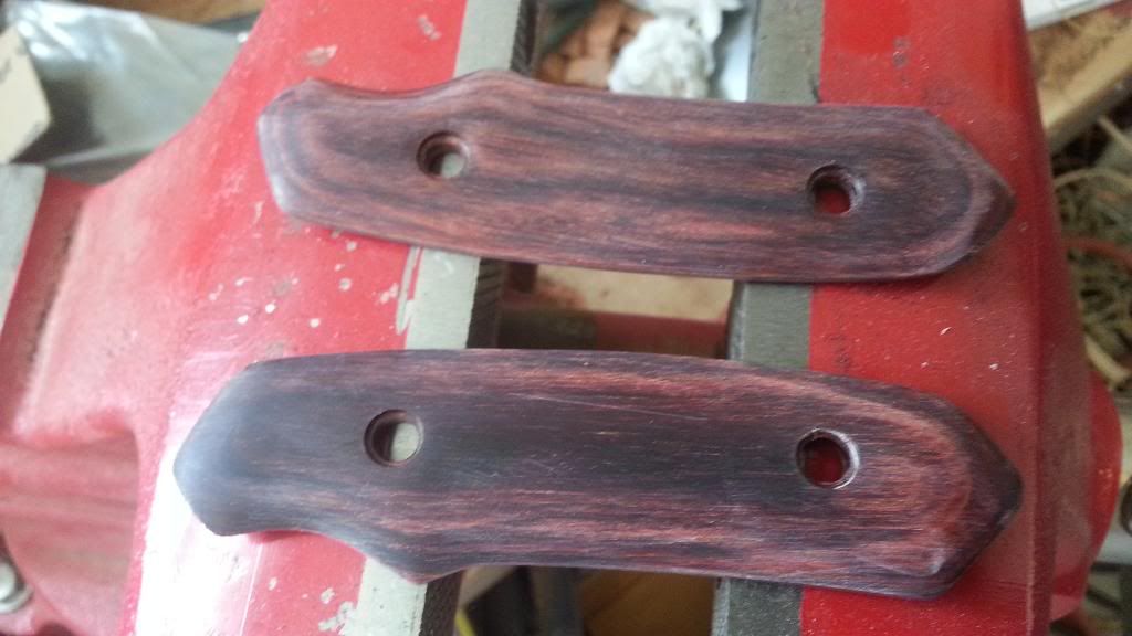

Dymondwood sands nicely though

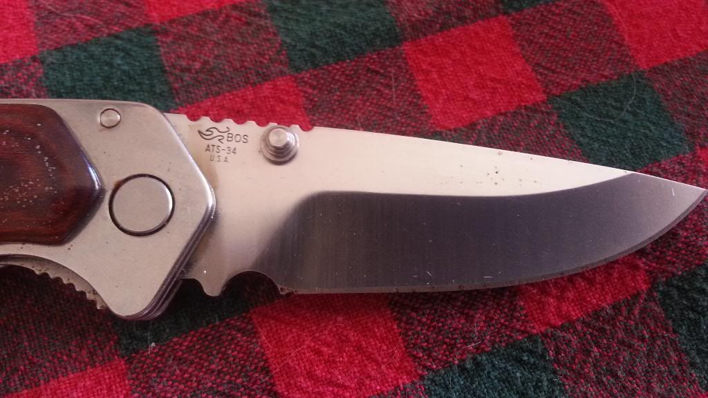

One scale Buffed on the wheel, and the other still with 600 grit sandpaper finish, for comparison.

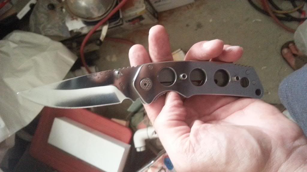

Gotta love the way it shines up on the wheel :)

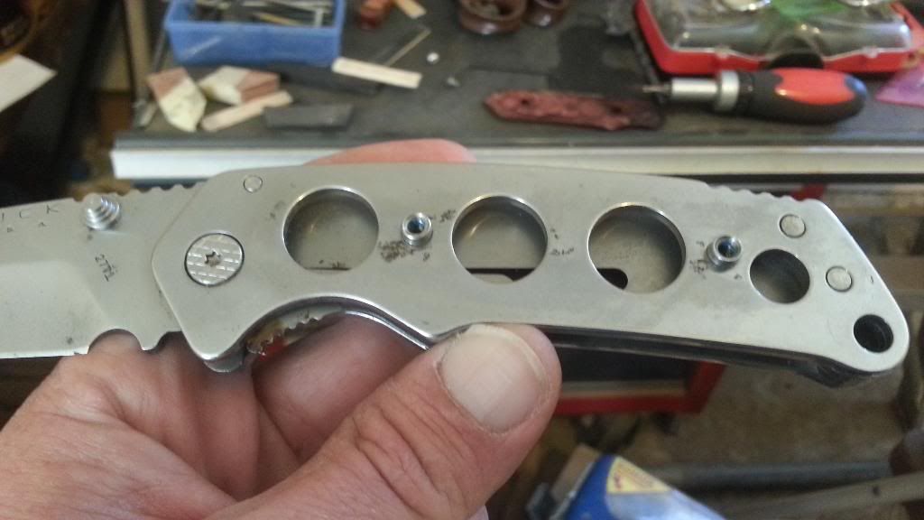

Buffed the frame and the exposed parts of the blade.
I am finding I like a polished blade, slippery smooth, and just seems to cut nicer.

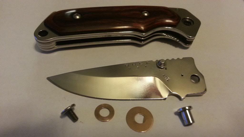

Removed the Blade and Pivot parts, and Buffed the rest of the Blade, and all the Pivot parts :)

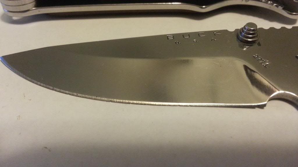

The Blade edge had some nicks/chips.....By the choil was a terrible one....
So I put her back together, lubed the pivot up, and proceeded to hand sharpen sharpen sharpen with benchstones, removing metal from the edge...... little Nicks and deeper chip are gone now, and she is shaving sharp again with a nice clean edge :)

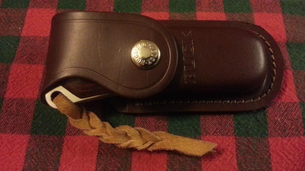

Luckily I had an extra leather sheath that I had previously ordered. Was going to use it for a 279 I plan on making scales for, but this knife is now claiming it ;)
And gave her a short lanyard for easy sheath extraction.
Overall, I am pretty darn happy with how she cleaned up, and will definately give her some belt time.
What a beaut. You did a great job on cleaning her up. I have the exact same knife. Got it from Craigslist. I can't wait to put it into action this fall.

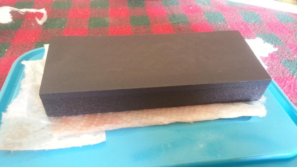

I used both sides of my cheap 5"x2" Carborundum dual sided stone (got it free :) ) lubricated with mineral oil.
The rough side is pretty aggressive, and works pretty quickly. To put a new clean edge on it.
and then my inexpensive ($7) 6"x1.5" 1000 grit ceramic stone first lubricated with water, then a little at the end used it dry.
It took an hour leisurely working on it while watching tv, to remove enough metal to get rid of the chip by the choil.
Good. Normally combination grit stones separate the grits at midway of the stone. Your looks thicker on the coarse grit and a 1/4" of fine. Who's your crystalline made by? DM

It is definately as you said.... the course side is much thicker.
Brother in law gave me the dual grit carborundum already used, so I have no idea who manufactured it.....
The ceramic 1000 is from Smiths. I use that one 99% of the time. Percect for touching up with minimal material removal.
