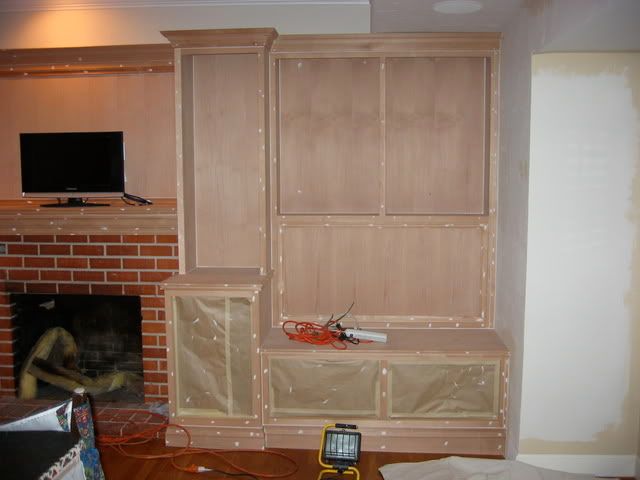

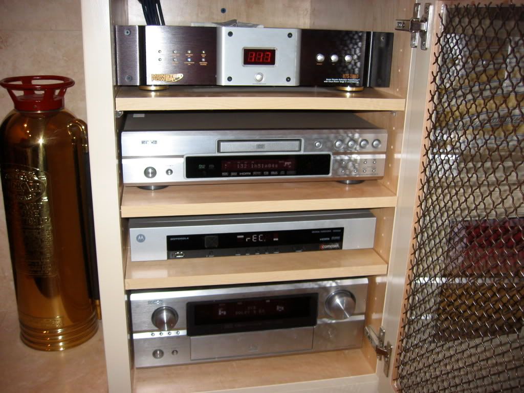

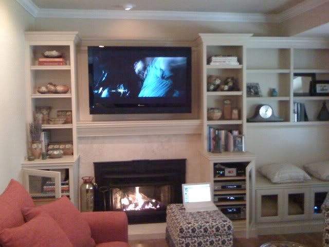

i am probably the biggest car audio freak you have ever come across. i have touched a little on home audio/theater. i recently did my parents living room. all in ceiling (moms wishes of not seeing the speakers comes before the needs of the system), pioneer 50" plasma on an adjustable mount, denon, veoldyne, a lot of higher end stuff. granted, not your full mcintosh setup, but it meets their standards.

sorry for some of the picture quality. camera phone..
