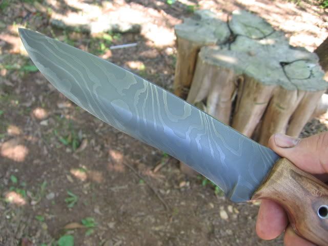

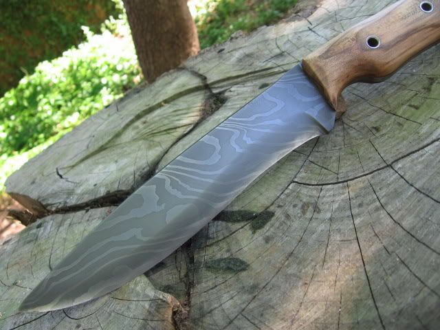

Here's one I redid after finishing it up,reshaped the blade and handle-Large at 13 1/2" oal blade is 8".I used 1095 and some strips I cut from a big woodcutting bandsaw,about 23 layers with a twist.Scales are Ambrosia Maple with red liners--thanks for looking-Regards Butch
A lot of folks love high layer Damascus, I love low layer. Good job.
I agree. I love the look of the low layer count Damascus.
