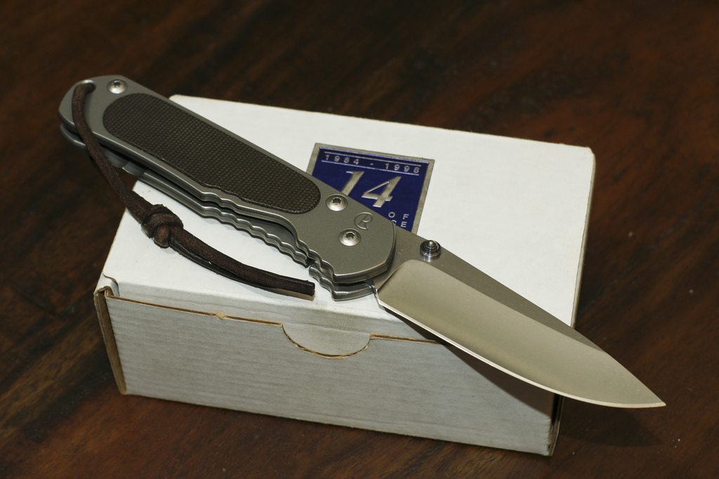

Not a replacement inlay, but I found this pic of a completely homemade one:

The main problem with replacing the inlays is that you have to do a clean job on the fit or it looks terrible. It's not really a "problem" removing the inlays undamaged if you take your time with it, it is a "problem" though so take your time with it. :p That all makes the job a rather large PITA to take on and you will really want to get it right, too. A CRK is not a cheap knife and a disaster of some sort would be strongly felt. The last thing anyone wants is 3 broken original inlays, mashed up corners on the Ti frame and badly fitted new inlays that you change your mind about right away. :eek:....:D
I have done a few inlays for the Mnandi and promised myself solidly that each time would be the last time. That said, the 3 Sebenza inlays may be easier shapes to match...but those subtle curves are always there. :p
Hmmm...maybe I should leave good enough alone. Has anyone tried this and failed? If anyone knows someone who did, how did they ultimately correct a botched job?
It seems like a pretty hard task to make 3 different scales with great fit that match up with each other well as well as match up with the knife(many ways to fail and few to succeed). This is one area where machining has a large advantage over doing it by hand. You may (or may not) also consider that probably 95% of customizations decrease the value of the knife. This would not matter if you will keep the knife forever, but many do find there way to the sales forum eventually. The one exception I can think of is Mayonized( and maybe a few others done by well known knife makers).

I've done inlays in CF and LSCF. I'm confident certain hardwoods could be done, too.
I'm not too active anymore, but I have an old photobucket account out there that show some of my past work.
If you had a link to that photobucket account, I would be curious to see some pics, but at this point I doubt I'm going to try to change anything myself.
