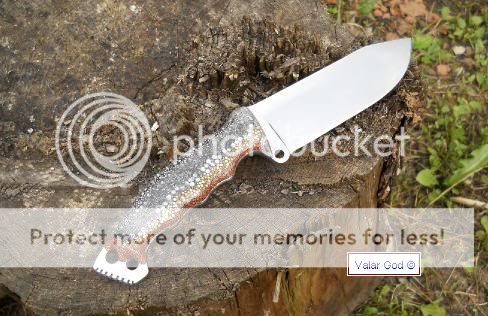

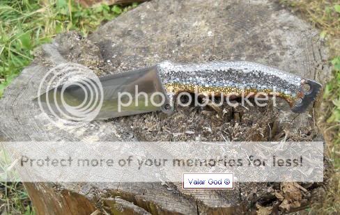

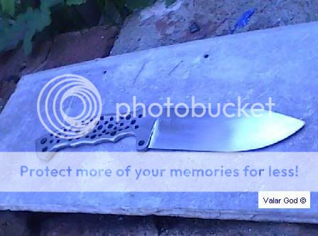

After a year since I have started this work
I have finally finished it.
Handcrafted survival knife by Valar God

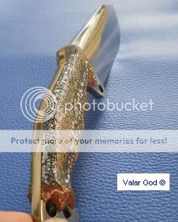

For the handle, I think this is the first knife handle of this kind in the world :D
The handle is made of orgonite.
Or, in other words, it is an orgonite handle.
What is orgonite, how it works and if it works you can find on the Internet.
My opinion and experience tells me that it works quite well
and I wanted to have an orgonite by my side
in a survival scenario.
Considering that I don't have the materials or equipment to make a wooden handle,
especially since I don't fancy all that oil soacking etc.
I came with an idea to "merge the pretty and useful" (we have a saying like this).

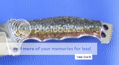

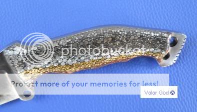

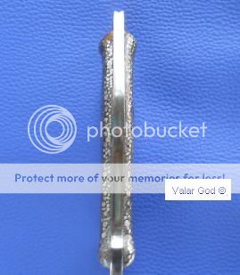

My idea - the first orgonite knife handle in the world !

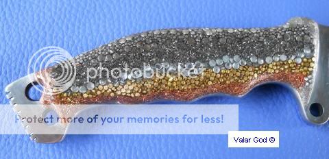

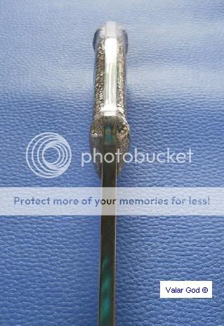

Orgonite knife handle by Valar God

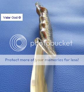

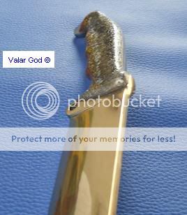

The handle is made to be a bit rugged
for the better grip.

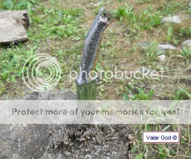

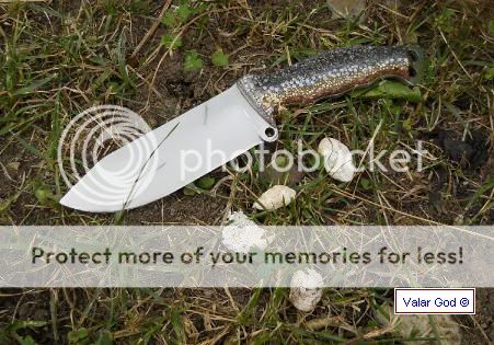

And we took a few pictures in a rustic environment:

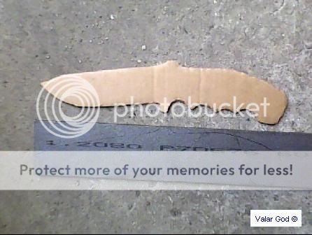

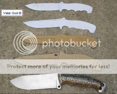

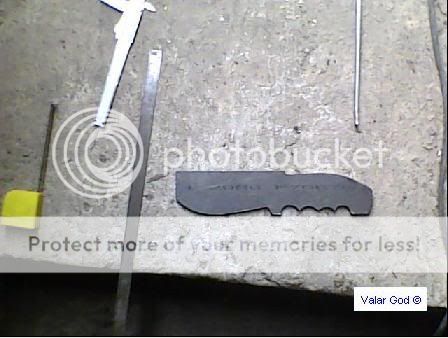

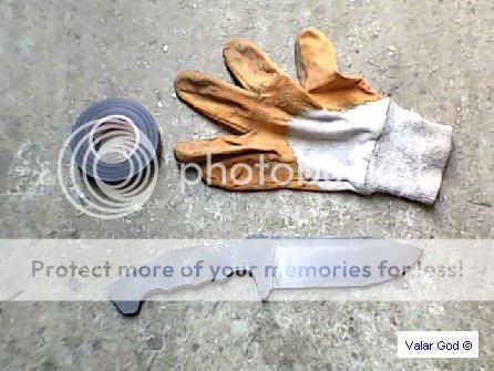

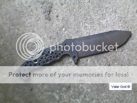

And how the production process went along.
The steel is D3.
As you can see, the end product is not always the same as the idea
but, as far as I am concerned, in this case, it is better that it isn't. ;)

The handle was cast out of, basically, epoxy resin, different metals and crystals.

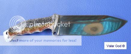

In my first post I wanted to say that the blade glows blue
in vicinity of orcs, vampires, zombies and other foes
but I am saving it for my (unique ?) machete that I will finish in the next few days.

Interesting knife....But yikes. Enough about the properties of "orgonite"...whatever that is. Last I checked this was a knife discussion forum.
1) What about the design of this blade makes it a "survival" knife? And please don't tell me orgonite.
2) Have you done anything with it other than take pictures of it on a stump? I know I'd love to see it cut something if one is supposed to rely on it for "survival."
3) How thick is the blade and why is there a hole in it?
4) Do you consider it a chopper or slicer?
5) Why the skeletonized tang?
From what I can tell on line, its pretty much standard knowledge almost any knife can be dubbed a survival knife, however most knife enthusiasts will look for more durable steel and handle material. Blade shape that allows for multiple uses and abuses. Which his knife does have, a shape similar to a lot of "Survival" knives or other heavy duty knives like Beckers, Ontarios, etc. Also it looks pretty stout, I have no doubt that it will hold up to making a shelter or batoning or other tasks you need done in a survival situation.
I have seen lots of expensive and inexpensive knives being sold without a single video or picture of it cutting anything, its not necessary as its understood the basic idea of a knife is to cut. It does look like he pounded the knife into the stump in one picture.
It looks like the knife is about 1/4" thick, or around 7mm. The holes are probably for lashing the knife to make a spear, as well as cosmetics.
Judging by the size, and a guess on weight ratio, looks like the knife will do both, its not going to win a chopping competition, nor is a sushi chef going to make it his dedicated knife, but it appears capable of doing a little of both. Its just barely long enough to chop, but just barely short enough to do more detailed work.
I'll take a wild stab at this, and say its for weight reduction,as well as the OP may prefer the feel of the knife being blade heavy in its balance, I have seen this done by many makers
Obviously I am not the OP, so I can't give you a 100% positive answer, I thought for sure he was going to answer your questions. I was going to put in a comment earlier but my phone madeitlook horrible, so apologies on the delay and for interrupting this Q&A session.
Valor God, I would heavily recommend pinning or riveting your handles on as well as just gluing them on. Even though you have nice thick steel, my opinion has always been with out pins holding in place the handles, the handle can get torn off or loosen up as you use it simply from vibration and micro flex.
Marcinek, I think you also asked about Magnesium earlier, edited?? Anyways, from the OP's first post, the knife has a scraper to scrape magnesium shavings but the blade and tang is D3 steel
