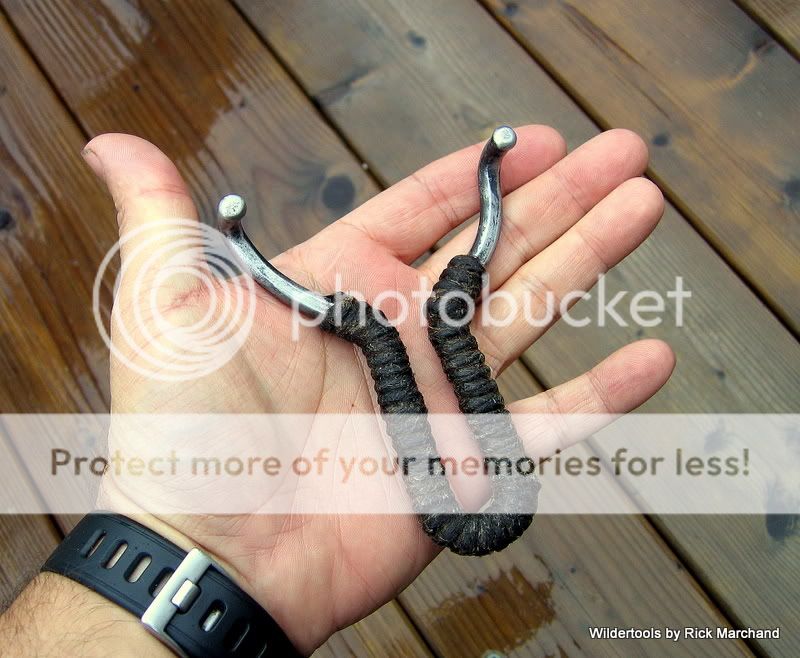

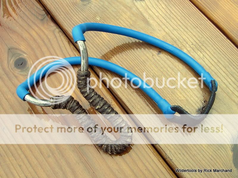

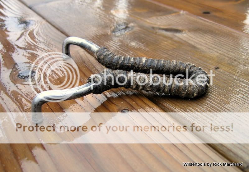

I have always used slingshots for fun and a bit of hunting/critter deterent. I see many folks have them in their kit but I never bothered. Well, I am reconsidering adding one to my bushbag. I have a moto I live by(mostly)... "If I can't make it, I don't take it." Slingshots are easy enough and there are a variety of styles to choose from. I like the compact Chinese/Dankung type but am lazy about making my own bands (don't ask why, they seem pretty darn simple). So I made a standard storebought-type slingshot in the Dankung size range. It accepts any "wristrocket" replacement bands sold in stores. Nothing needed outside of a propane torch, pliers, hammer and some sandpaper. Wrapping the handle can be done anyway you like... from epoxied cord(as pictured) to a tight fitting piece of garden hose. Give it a shot... a slingshot!

Are you going to add a wrist strap? I added one to my Dankung, I don't even have to grip the handle, I can shoot it open handed. I guess it depends on the power of the bands and one's wrist strength.

I was assuming the frame was aluminum. Now I'm wondering if maybe it's steel. In any case, what is the diameter?
