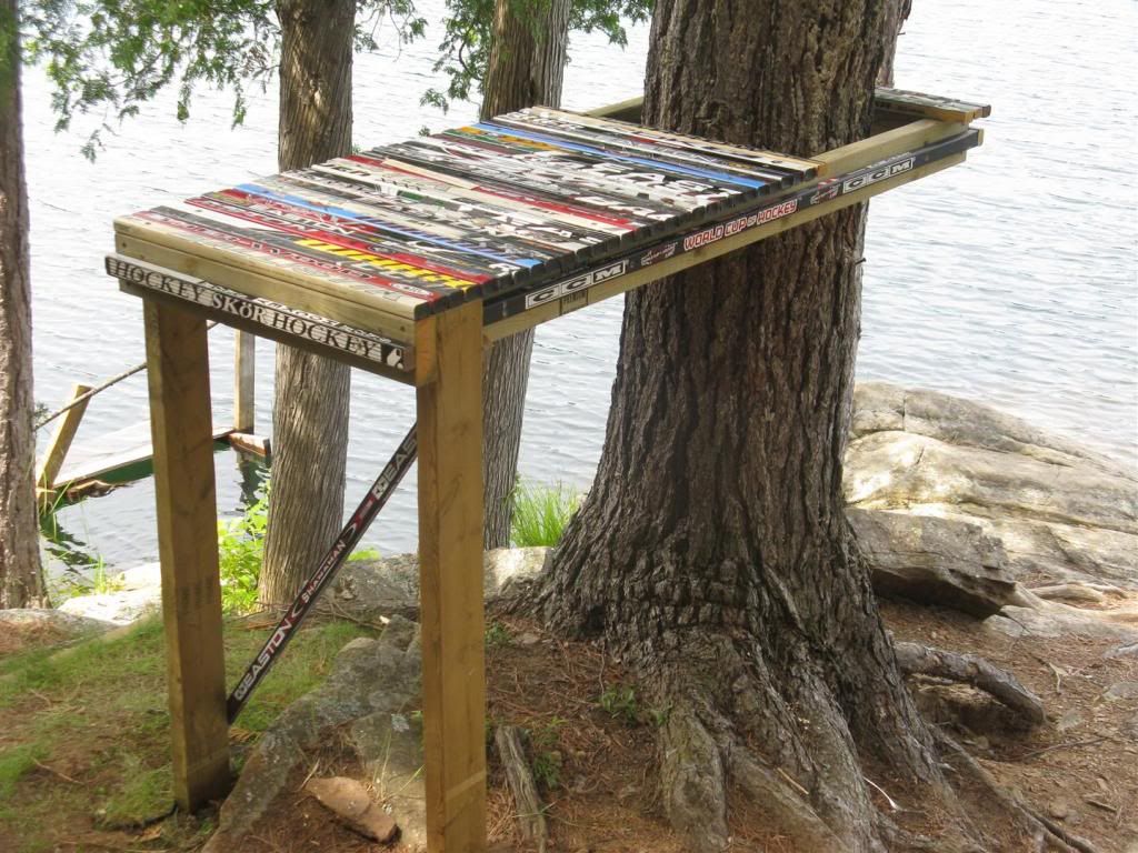

Hockey sticks are made from various types of composites these days. Some of the expensive ones are unbelievably tough, durable and light. Maybe you want to check the garbage cans at your local arena for some broken sticks to experiment with. You're going to be constrained by hollow rectangle sizes of 1 1/8 x 7/8 approx but at least the expense will be negligible. I save busted sticks for making campsite furniture and the days of them being made of wood is disappearing fast.
Thanks 300Six! Hadn't thought of the merits of salvage. I was thinking in terms of from scratch. But that would definitely save a lot of money.
There is huge variation in material and manufacture, and sizes, and some are more oval in shape or with rounded corners than others. Kids, women's and senior's sticks are smaller dimension. I don't know how they make these things (extruded, spun?) but they've gradually taken on the properties of good hardwood, and then some.
PS; when I say 'broken sticks' it typically means the blade has been severed. A testament to the strength of these materials is that it is rare for the shaft to break.
