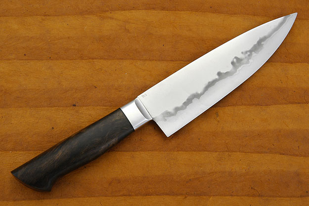

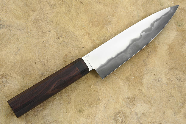

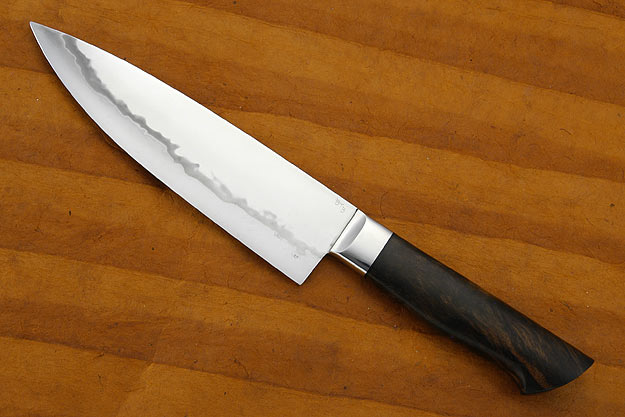

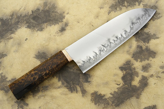

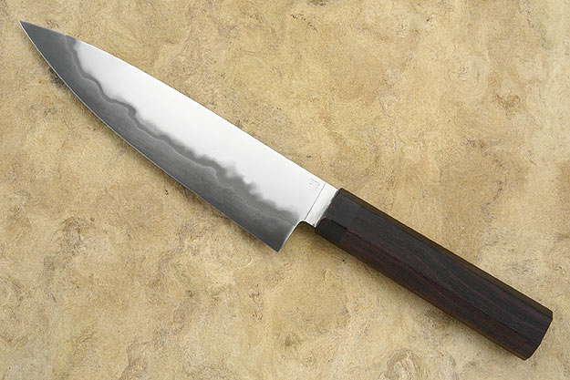

here are a couple of japanese style kitchen knives that I finished recently.
This one is 410 stainless over 52100.
This one is 416 over 52100.
And this Santoku is also 416/52100
the blades are .1 .11 and .11 in thickness at the handles and 7 1/2 inches long. they have a full convex grind right down to a zero edge and a full distal taper.

I agree fantastic hamon. The top 4 knives reminds me of the clouds drifting across Mt. Fuji on ukiyoe prints.
