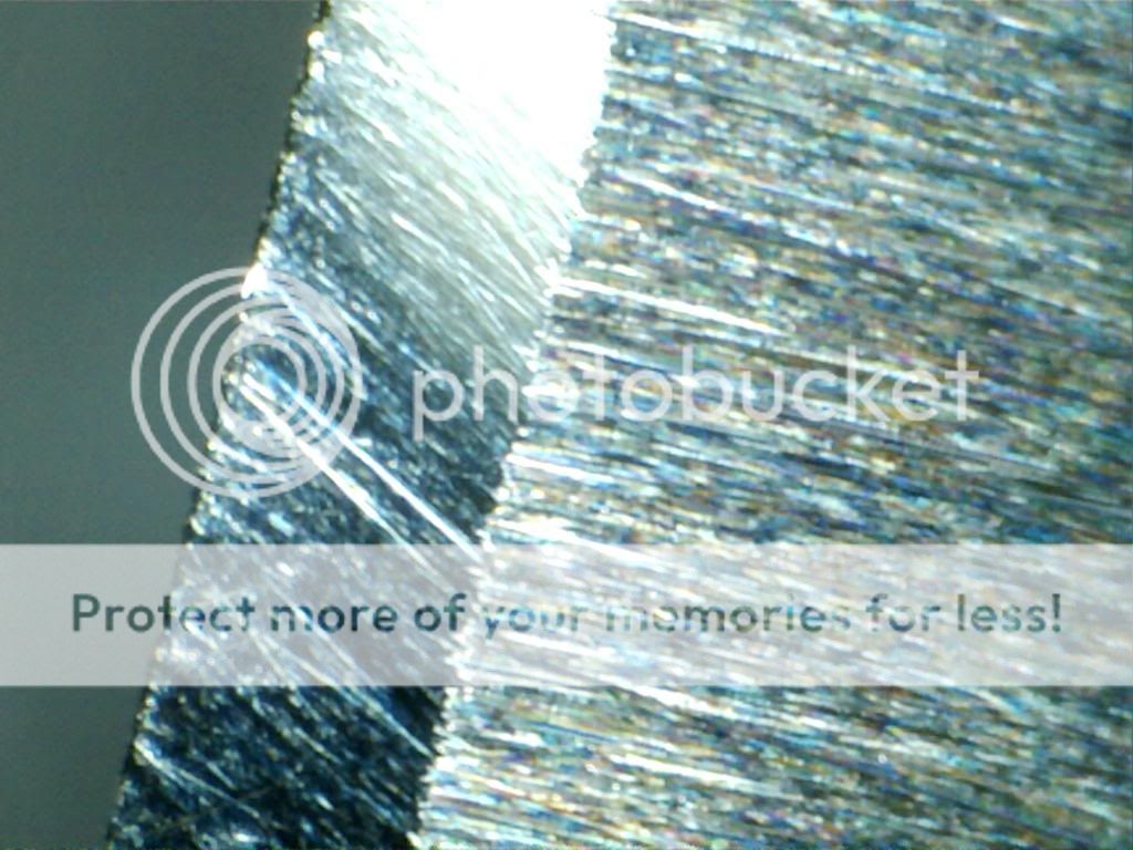

So I got a Dovo Carbon Straight for Christmas. So first thing to do was to hone it of course :)
So I took the factory edge.
Not particulairly impressive , large random scratches , looks more like a saw than a straight razor , they stropped it with a poor strop because there was some convexity at the edge of the edge.
And I turned it into this.
This required a significant amount of work. I actually had to break out the Atomas (600 and 1200) to get rid of all the convexity it came with. Once I had that accomplished I dropped down to the shaptons (220 and 1k) to remove the diamond scratches. Then I switched over to Japanese Naturals and that's the result.
I did this freehand on 1x6" Edge Pro stones.
Thanks to Ken and Tom for the Advice :)

How do you find shaving with the Dovo? Does it pass a HHT, and what angle is the bevel?

So I did a test pass with factory edge (shown above) and was less than impressed. So then I honed it to my spec.
Shaving is as comfortable as I make it. Im still learning. But every shave is considerably more comfortable than the last.
The geometry is whatever dovo sets it as , you use the spine as an angle guide. This razor passes every test I have been able to throw at it.

Riiight. Forgot the spine sets the angle. You should measure it anyway, just because.
