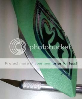

I have done the salt-vinegar-cell phone charger etching and deep etch of maker marks with acid for a while, but I have decided to try my hand at an old school technique while simplifying the materials used. It's called aguafuerte in spanish, and it involves the preparation of an acid-resistant ink and dipping the blade in acid. It requires a steady hand and drawing knowledge. I'm constantly amazed by the work of Antonio Montejano, the guy does simply stunning etching-engraving with this method.
Well, I decided to try it with simpler stuff. I taped the tip of my stripped BK4, drew a simple design on it and cut away with a hobby knife. I had to keep in mind that I had to take the tape off the areas that would not be etched first (this is my 2nd try, first one got a little bit messy :rolleyes:). These areas then got covered with a printed circuit marker fluid (acid-resistant ink). After letting it dry, the areas to be etched get the tape removed from them. It's pretty much like doing a stencil, but I have tried stickers and spray paint before and didn't like the results.
Making sure that the marker ink is dry, I proceed to saturate the design with PCB etchant with a q-tip and keep on dabbing it whenever I see it starts to get dry for a couple of hours.
the "stencil"

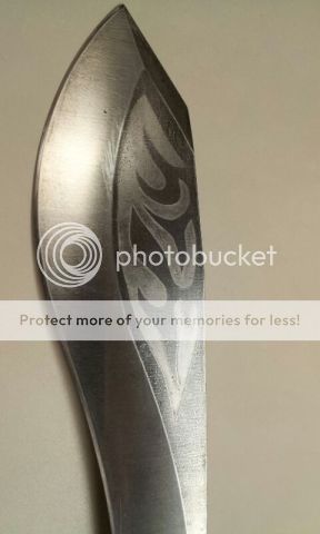

the result, after a light sanding with 400, 600 & 800 grit
I will try another design on the other side using the salt-vinegar-electric charge method and compare the results to see which one I will keep on doing. Hope u likey :D

So, did you have the bevel and back taped up and then the etching was all on the flats?
I taped the back and almost all of the bevel, shoulda taped all of it as some acid went over the untaped portion when I washed it. A bit more of sanding and a lesson learned.

I finally did the other side, this time with salt-vinegar-electric charge. Flipping the blade from side to side, you can appreciate the different effects caused by the different techniques. The acid etch gives a more "natural" impresion, more suited for classic-styled blades, while the electric etch gives very defined edges. I will keep on playing with both methods on different blades as I have no particular favorite right now.
