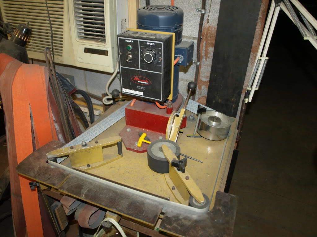

Hello to all members. As some of you may know I build vertical knife making grinders and now would like to come up with horizontal grinder. I would like to get as much input from knife makers as far as what they would like to see on one and and what would be really important to have on it. I would like to make it to take 2'' x 72'' belts to keep it simple. If you have any ideas or pictures of what you have built and would like to share them I would appreciate them. The idea that I have for this is to gather everyone's input and come up with a horizontal grinder that will perform really good and not to copy anyone's machine. I currently use a John LeBlanc horizontal grinder but do not wish to copy it. Here are some pictures of my horizontal grinder and the vertical grinder that I make to sell. Thanks in advance for your input.

HERE'S A LINK to my horizontal.
I too have a LeBlanc and don't really like it.
I like the 3 wheel design better as I can get into more places with it, and use any sized wheel I want.
I have a 1/8" wheel for this !!!
The JL tensioning system is overly complicated, and has already failed on me, prompting a re-build.
I have a 6" wheel coming, so the drive wheel can do double duty as a contact wheel.
This page wasn't created as a showcase of the grinder, but to give a buddy of mine some ideas when building his own.
Neat looking grinder you got there, I can see Johns influence in it.

Thanks to all for your input and hope to get some more. Here is the John LeBlanc grinder that I use. I must say it is a Cadilac. It has a lever for a brake that will stop the motor from turning and make a quick adjustment, the rests move up and down and allow you to use the full two inches of the belt which is really nice. Another thing that is really cool is that the unit can just sit on top of any bench with out modifing the bench and it is variable speed. It has a 1 1/2 hp motor. What do you guys think would be good as far as HP rating on the motor?

I started with a LeBlanc like Enrique posted.
Quickly ran into limitations to my style of making, so I built a tooling arm.
Still not satisfied, I finally just designed my own.
The JL is an outstanding machine, and well built.
It is just a bit limiting to me as it has 4 wheels, and the wheels are not easily interchangeable.
I am debating selling the JL to fund another build or two...
