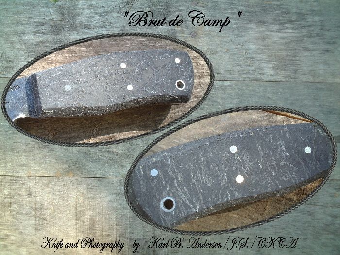

Joe, I'm sure someone that has actually used the stuff will chime in, but the ones I have seen have been glued directly to the tang and have a brass or stainless pin. The pins were anywhere from 1/8"to 1/4".

Some high grade epoxy to get some bite and a few pins to keep things from sliding around. It's the shearing action that will loosen handle scales.

Karl-- I love that forged in guard on your knife! that looks really nice.
