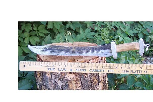

here is a plemnary stump-test on a Save Edge "Beast" rasp.
I LOVE IT! ONE NASTY BASTERD OF A BOWIE! YOU DON'T HAVE TO WORRY ABOUT SCRATCHING THE FINISH!:thumbup: :D
