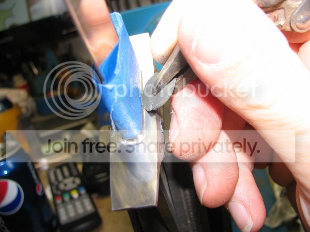

Charles, do you apply solder right to the front seam of the gaurd? How do you clean up/finish the area?
I aim the heat to the bottom of the guard holding the heat gun at about 45 degrees, so you are heating the guard and tang.
Apply the solder to the front of the guard after it starts to flow use a sharpened stainless rod dipped in flux to help coax the solder around the joint.
For cleanup I use a nickel silver rod sharpened at a 45 degree angle as a graver to clean up the majority of the excess solder. Then I use a small chisel edge Cratex wheel held in a small pair of needle nose Vise-Grips. Drag the wheel along the solder joint to smooth everything out. Then use a small buffing wheel and a Dremel Tool to buff the joint.
I hope some of that made sense.
Here's a photo of the Cratex wheel step.
That's awesome, I never used a cratex wheel by hand like that. I'll have to try it.
I always left gouges in the face of the guard when using the Cratex wheels in a Dremel, especially when trying to clean up the solder at the top and bottom of the blade.
This method takes longer but I like the results.
