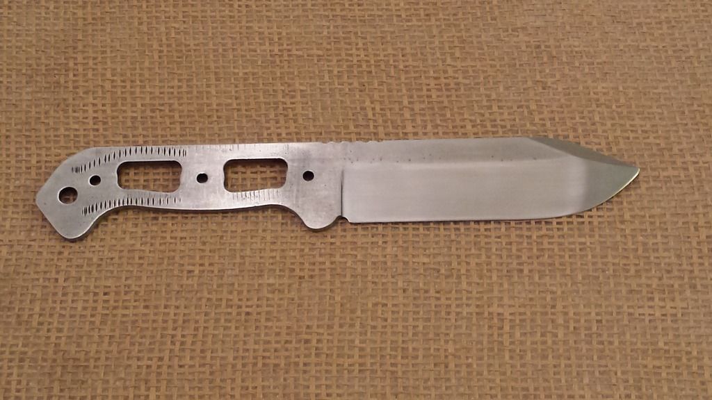

What is the best way? Once you get the vinegar boiling hot
Ive saw a video where the guy submerged the whole blade in a tall container...
OR
I read that you use cotton balls and just wipe it on the blade.
I think it will depend on the type of patina you want. Submerging it will give it a more even color/look. Applying it with anything will leave a pattern of some sort on it.
I've noticed no difference in hot or not. Are you going for a solid dark or splotchy? I use a tall glass, remove the scales, hang the knife by a pencil thru the handle and fill to desired depth. My patinas turn out best and darkest from drying rather than soaking. The think the air quickens the darkening. I like splotchy patterns myself. Very thin coats of mustard or Sriracha. The thinnest spots that dry give the darkest spots

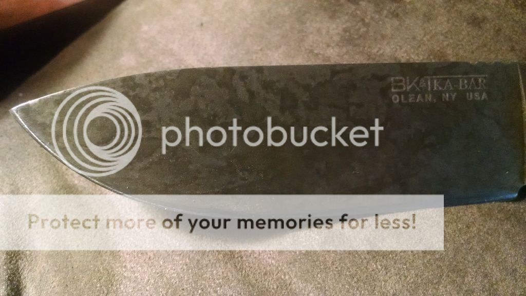

I used regular vinegar and I took this tin and suspended it over 3 tea candles for the heat.
It produced enough heat to warm up the vinegar almost to the point where it was too hot to touch.
The result.
Search around and read thru threads. There's many here and everywhere with how to's etc. If you don't like a result just sand it off and try again.
I like that deramped 10! If I ever grab one I'll do the same, and take down that front hump a bit to round things out. Nice patina job, sorta psycadelic.
