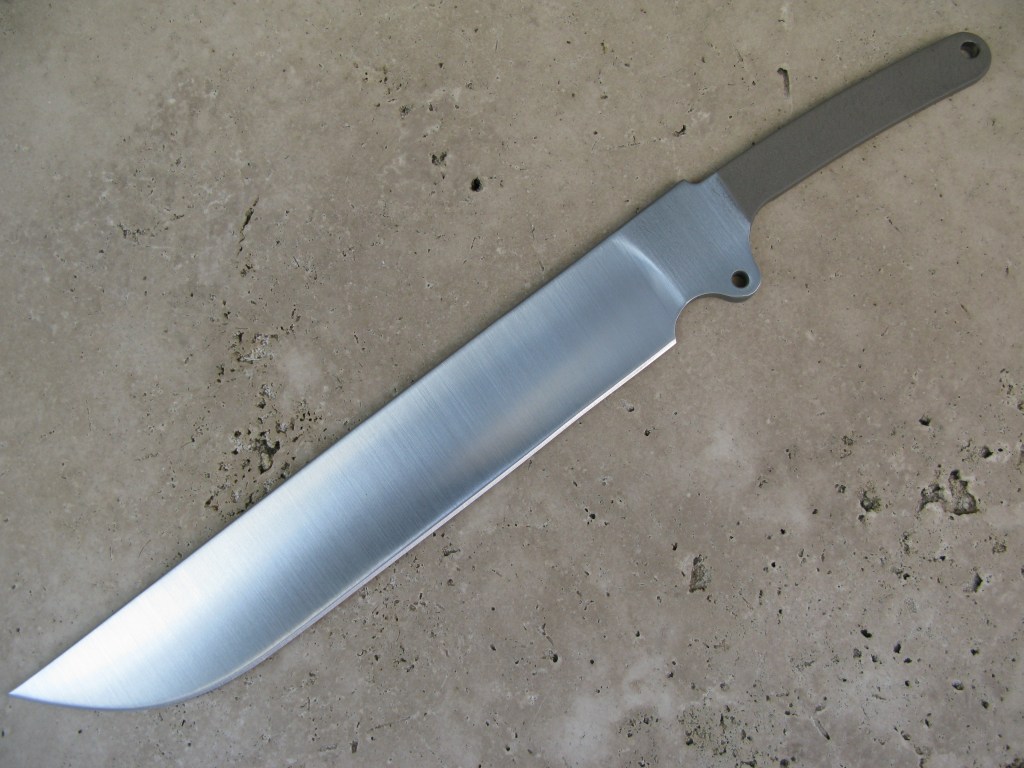

Looking over B10 pics got me wondering how the Basic LEs are finished under the handle. Living on the coast has me trippin' on corrosion vulnerabilities.
In this borrowed picture of a B11 mod, it appears that the coating was deemed beneficial to keep:
photo credit: Norcalblacktail
What say ye, Busse Wizards? The B10 is for scuba?
I cant answer that question,but I will say
you wont find me swimming where
I need to carry a Basic-10 :D
Just spoke with Amy (which is always a pleasure) and she let me know that the Basic LEs are satin under the handle and there is no protective coating; contacting Garth to discuss possible custom work would be the way to go if I would like that insurance against rust under the handles.
Frankly, kind of bummed. Please, somebody chime in here and assure me that these handles will not turn into rust gloves over time. :o
