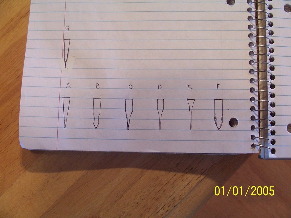

Here's a cross section on some of the current blade grind offerings. A= full flat grind, B= Bucks semi hollow grind, the type grind found on military knives of the 40-70's C= Bucks current flat grind, D= Bucks current hollow grind, E= a full hollow grind (mostly found on custom knives), F= a convex grind and G= the grind found on Bucks sabatier kitchen knife (flat with a hollow grind the last 1/2". Should you reduce the bevel shoulder on the B grind it could easily get close to a scandi grind. DM
This is why I found 'E' to cut the best cutter/slicer. With apples, cheese, skinning, ect.. Then G a very nice cutter for kitchen use and D, then A. Two grinds I did not draw were the chisel and saber grinds. The later used on Morseth knives and the chisel I see used on tanto blades, popular today. DM
We all have different experiences and I appreciate them. From my experience, E is the best cutter, unless the material being cut is deeper than the knife is tall from edge to spine. Then, it tends to bind a tad and push the material out from the blade. Slicing an apple very thinly produces broken or cracked slices, for example. However skinning or processing meat is where E shines. A slices things like apples and potatoes best and that is why you find this grind on thin best quality kitchen knives. You can actually see the cause of these phenomena in the drawings. Another example is that my Spyderco Caly3 will out slice my Buck 110, or any other Buck I currently have, when it comes to such things. However, cutting rope, hose, and etc. the high hollow grind is slightly better due to the thinness of the knife blade down to the edge.
