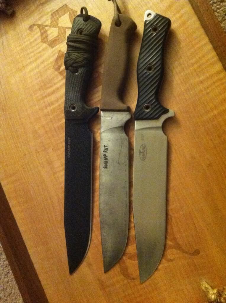

Here are a couple of pics with my favorite using 'kin knife, the B11.
R9 is very stout with robust heft. What, am I talking about beers now? :foot: Balance point is just behind the "T" in Swamp Rat logo. Choked up feels amazing. It also feels great in standard grip [i.e.; hump dividing middle and ring finger], and would seem to be so regardless of hand size (although index finger may not reach top of inner handle with smaller hands).
In rear grip [hump dividing index and middle finger] it has what feels like identical forward weight to the B11. Pic below matches grip locations and shows equal reach when held as such. I'll be sure to put a lanyard on when I try it in that position, though.
