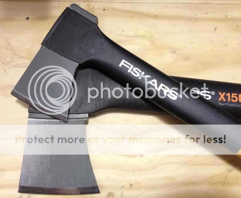

I very rarely use an axe, I have a fiskars hatchet, and their X15 (I believe it's cruiser sized)
Both get sharpened following the factory bevel, although it has become slightly convex.

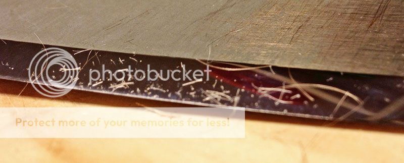

Once I blunted the factory edge, I took off the grey paint, and ground out all the roughness with a cheap course diamond stone, then used wet/dry papers from 320 to 2000 grit, then bark river black and green compounds to finish.
The end result is a pair of scary sharp edges with mirror bevels.
X15 - I used it to chop tree roots, the sand messed up the edge and the nonstick coating on the head
You wouldn't know by looking at the edge when I was done !
both - sharp but not polished
x15 again
