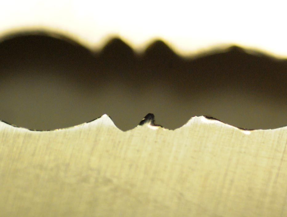

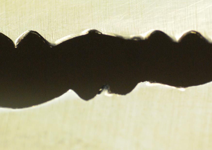

I took a few photos today- these are extreme closeups of 2 different SE Enduras
Jason's advice on method worked for me on several serrated blades. Just make sure it sharpen the back (flat) side at a very low angle. Have the spine lifted just slightly from the stone. Then get a burr on the scalloped side. Then remove the burr and do some balancing strokes back and forth.
That being said, some of the points and curves on those blades are bad enough that they won't be reshaped by a simple sharpening. I'm sure you can get them sharp. But if you want the original shape back, they need to be reground, preferably by the original jig that made them. I think Spyderco will do it for you for a small fee.

If the serration is really creamed, I've gotten very good results clamping the knife in a vice and using a DMT tapered rod to restore the serration to something close to the original shape. It is time consuming.
