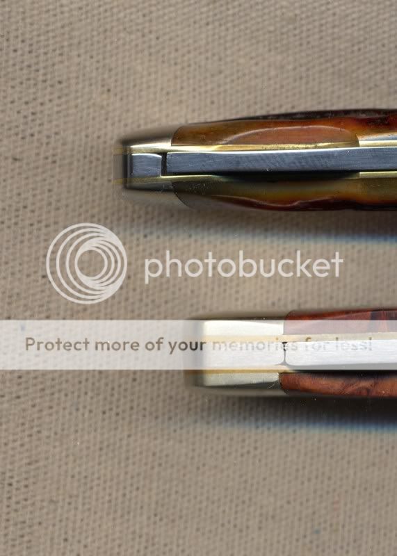

Look closely at the "fit and finish." Look for gaps, parts that aren't lined up quite right, sloppy work, etc. Here's a good comparison photo displaying fit and finish. Which one would you prefer?
