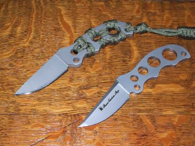

Would someone be courteous enough to explain to me the difference in hollow and flat grinds?
Flat ground mantains a contant angle from the spine to the edge
Hollow ground has a concave shape, if you hold a buisness card across the blade you'll see light near the center of the blade.
ThatMGuys pictures show both grinds, the top one being flat ground.
Saber ground is flat groung to the edge from a point below the spine.
Clear as mud. ;)
