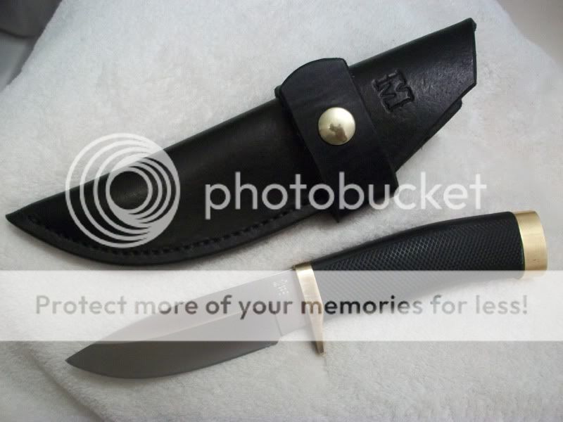

The fiebings standard spirit dye left a really dull finish after it dried. I knew to wipe it all off, but it wouldn't come off as easily as the brown I tried. And it left kind of a weird rainbow effect....Like I was seeing alot of reds and blues etc. Took forever for that crap to come off. I thought I'd get the cloth a little damp to help, but it rubbed the dye right off, and you could see splotchy areas where the black just didn't get in. Strange stuff...lol
I ended up finishing the sheath though, and it turned out ok I think.
I'm just going to dunk the whole thing like Chuck, or do what Paul does....buy some already dyed leather! lol :p :thumbup:
Oh btw....here's the sheath I had some trouble with.
