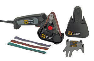

I was hoping someone with some experience on the Darex Worksharp could tell me how to sharpen the tips on my knives without rounding them off. I have tried letting off the power just before the end of the blade, and not pulling all the way through, but then the tip doesn't get sharpened. Is there some happy medium I need to reach, or a technique that I'm missing?
You need to finish your stroke with the tip on the middle of the sharpening surface. I'm not sure if your rig is powered or not. Don't wrap the tip over the edge of the sharpening surface. I don't like sharpening rods because it is hard not to wrap the tip over the round surface (dulling the tip).
Practice on flea market knives. It's all in the wrist.
It's this, a small powered belt sander:
So far I'm only using it on my junky old kitchen knives. I've managed to get the majority of the edges very sharp, I just end up either rounding off the very point, or not sharpening it at all.
Lift the tip up off the belt before it slips off on it's own. This takes some getting used to as there is an ever-so-slight pause at the end of the stroke, which can make a facet on the tip. Not a big deal, though, and easy enough to correct.
I've never used a Worksharp, but I use a belt grinder at home and a Chef's Choice at work. The Chef's Choice is guided like the Worksharp, so I know there may be limited space in there in which to lift.
Definitely practice on the old kitchen knives until you feel confident. I no longer use the guide that comes with it, and so can hold the knife a little higher on the belt where there is less slack. That helps a lot. Given the choice between rounding the tip, and not sharpening it at all, I'd rather stop a little early, and finish the tip by hand.
