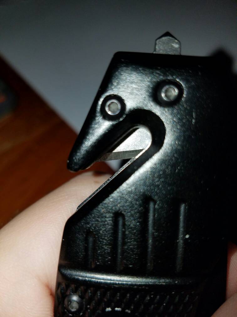

How do I sharpen a seatbelt cutter on my knife?

This is what in talking about

Replace the removable/disposable blade...[emoji6]
they can be sharpened like any other blade...on a benchstone<s>, just steeper angles...
and those extra small disposable blades are extra hard to get ahold of correctly...
is it time-efficient to do so?...no, but it can be done-- I've done it.
Remove the screws you see in the pic....and take it out. Either sharpen it or replace it.

What kind of knife is it, if it's something from a gas station or flea market like it appears to be I'd say just throw the thing away and get a real knife ( the buck 482 or buck bantam are 100x better and only 20$ )
How many seat belts are your cutting, that it needs sharpened?
These are never really very effective, because of the design and because it's hard to get into your pocket when in the seat of a car ( especially in a wreck )
I think you'd really be better off getting a rescue me tool to put on your car keys.
Now if you really want to sharpen this thing, you can take it apart and sharpen it on a whetstone but just be warned that the hardware on cheap knives always strip out easily and once they've been loosened ( assuming the heads didn't strip on you ) you'll need some loctite or it'll fall apart in short order.
Just work it back and forth on the stone, then give the backside a few pulls on a fine stone to remove the burr.

Hi,
these things rarely get dull as they're rarely used to cut anything
I've had an envelope cutter for decades and it still cuts paper,
ie its sharp enough to cut a seat belt
If it is so dull it wont cut paper you could use some sand paper glued to a popsicle stick to sharpen,
but if it cuts paper leave it alone, because thats all the "sharp" you need for seatbelts
Give it a try, take an old sock or tshirt or jeans or some rope or some printer paper or index cards,
if you can cut any of those things its sharp enough ... basically test your equipment before the accident :)

I dug up an old knife using disposable blades a few days ago when I was looking for something to try my "new" translucent Arkansas stone on. The spare blades had an edge looking just like yours, the same kind of coarse grinding marks showing that the manufacturer didn't really care if the blade actually was sharp. Didn't shave arm hair then, gave it a couple of minutes work on the stone and suddenly my arm had a few new bald spots.
If you take the blade out and sharpen it a little on any fine stone you have it will probably improve dramatically. Not sure it'll cut seatbelts very good anyway, but it WILL be sharp.

Seat belt cutter or gut hook. Easy to touch up.
Take a leather bootlace, charge it like a strop, tie one end to a post, and use it to strop inside the hook.
