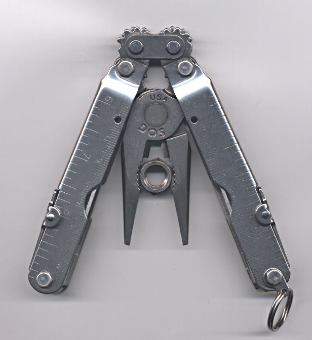

The jaws on the powerlock don't open up far enough in relation to handle position for functionality. On a 1\2" nut the handles are open too far to adequately grip and use. I compared this to my full size Gerber and my new Skeletool and both work fine. If you buy a Powerlock keep the reciept and try this test.... By the way I have considerably large hands.
The compound leverage pliers are such that the handles open wide. I suppose that could be considered a drawback as well as a benefit of the compound leverage. Whether I'm carrying a Leatherman or Victorinox or SOG multi-tool, I usually get a wrench from my toolbox for unfastening nuts and bolts--don't want to strip them.
There are a few wrench based multi-tools that might be of interest. I think that the older ones (e.g. Lunawerk or Hoffritz) are quite nice. You might also have a look at the Spyderench. Carrying a small adjustable wrench may be another option.
The jaws on the powerlock don't open up far enough in relation to handle position for functionality. On a 1\2" nut the handles are open too far to adequately grip and use....
Due to the unique geared action of the SOG PowerLock pliers, you can grip larger objects by positioning the handles as shown below. The handles are closer together in this position.
I have used them like that a couple times- it can be useful. I like the key-ring mod. I lost my first Powerlock in the Farmington River while I was fishing- a dummy cord would have prevented the loss.
