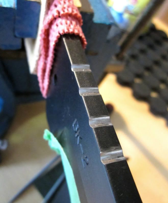

This is what i did,
Vice + Dremel cut off wheel + round file (some sand paper also)
Thankyou :).
I found placing tape either side of my thumb when placed on the spine gave me a better visual of how much jimping i should do (in this case i went for x4)
